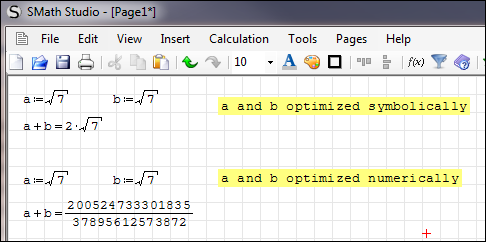

It is simple. Symbolic optimization means that program will not apply to the expression any numeric operations. In result you will always (ok, almost always) have expression identically equal to the initial, otherwise - it is an error. Another side of the question is that symbolic optimization of SMath Studio is an symbolic simplification. Simplification is a very hard task to implement for developer and this is actually why you have so many questions/bug reports to it. When you use numeric engine instead of symbolic you must accept possibility of calculating errors like 1/3=0.333; 0.333*3=0.999 (I'm simplifying it a bit, but this is good example). So, symbolic optimization should be always set by default.
Another example:
