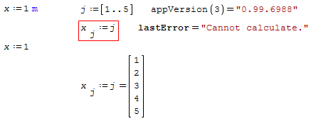

if x is 1m, the loop fails, if x=1, it succeeds. Any idea, what is going on? How to explain?
unit-range.sm (4,53 КиБ) скачан 1409 раз(а).

#4 Опубликовано: 25.02.2019 16:33:07
601 сообщений из 1 382 понравились пользователям.
when you assign 1m to x, it doesn't accept to be vectorized with range function afterwards.
making x a vector firstly, the problem is gone.
my diagnosis is; data type error. similar to C++, Basic, etc
regards
sergio 25.02.2019 17:14:00
#5 Опубликовано: 25.02.2019 16:46:43
regards
Sorry, but the problem is that the presence or absence of the unit in the existing value of x should not matter regardless what you are going to assign to x afterwards.
The failing implicit loop doesn't have any units involved, I would expect the loop to cleanly overwrite whatever pre-existing scalar value. I am well aware that pre-existing matrix values may proagate to the result if the dimensions are bigger than what is adressed in the loop.
Also, if there is some problem which can't be fixed, I'd vote for a better error message. In the given case, "Cannot calculate" will leave most users in frustration and dispair.

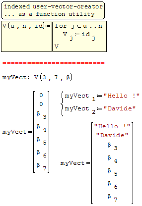

Hi. THis also fails too. Actually, it is a short form for the function NameVec in mathcad.
#8 Опубликовано: 25.02.2019 20:04:02
"can not calculate" because "syntax error"
"can not calculate" also appears in 6179 and 5346
resulting from more than a single "syntax error"
#9 Опубликовано: 26.02.2019 07:27:45
Thank you we'll check it. I agree that the behavior should be the same regardless if there is an unit.
There's no indexing in your LHS; the syntax you were looking for is the following:

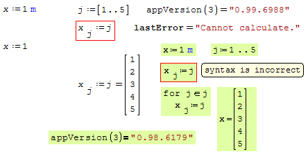

"can not calculate" also appears in 6179 and 5346 resulting from more than a single "syntax error"
This is because implicit assignment loops by vectors are available since SMath Studio 0.99.6638, in previous versions it's invalid syntax.
Yes Davide, missing for local implicit previous 6638.
It turns red some of Ber7 & Alvaro stuff.
For the essentials, I don't miss local implicit loop.
Oh, yes, thanks. That's correct.
