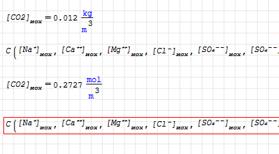

Hi Valery. I guess that it has some minor issues about units and with variable redefinitions inside of the body of procedures.
Predochistka.sm (65,34 КиБ) скачан 1464 раз(а).

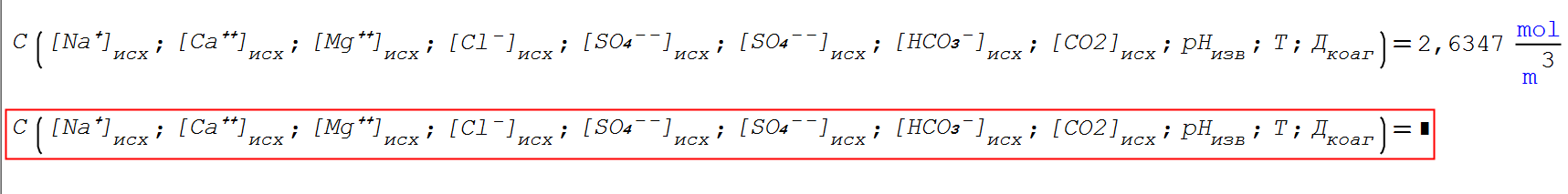

I call the function one more and get an error. Why?
Predochistka-Err.sm (62,61 КиБ) скачан 1477 раз(а).

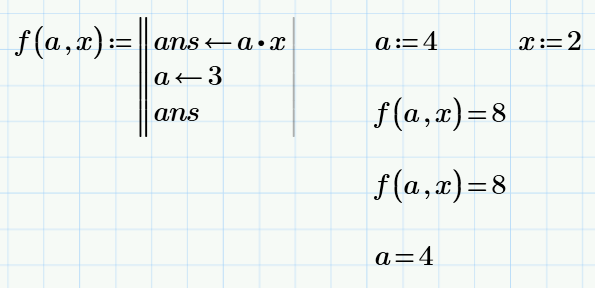

You redefine some function arguments inside the function body. That change its values globally:
See the green area in the document. Also, as an example:
Prime
