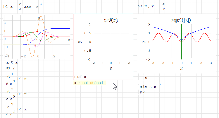

Did plot correct 5346... 6179 "x not defined"
Can't understand something in there.

You are right Jean,
BTW, it seems that many of the functions from "Statistical Tools" plugin can not be drawn neither with X-Y plot nor ZedGraph anymore.
I suppose some bugg were introduced here.
#3 Опубликовано: 17.12.2016 10:51:53
Thanks Radovan for confirming the bug.
Sorry for the crappy image. My e-machine XP died three days ago.
