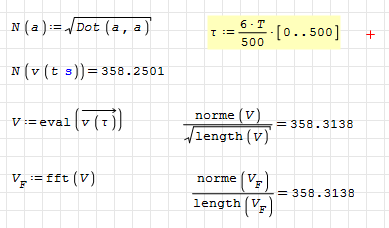

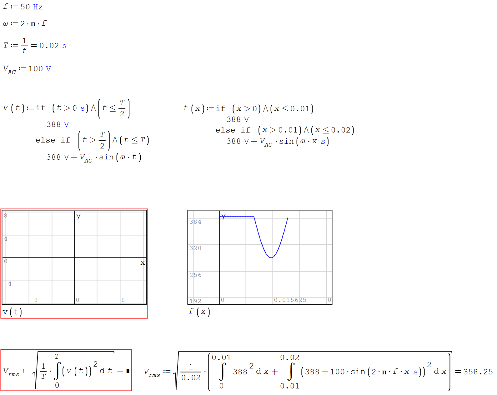

I tried to calculate the effective value of segmented voltage waveform, but failed, could you help me to fixed it? Thank you very mucn! RMS calc.sm (10,21 КиБ) скачан 1001 раз(а). image.png

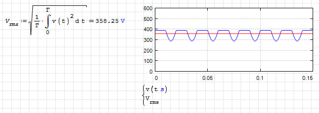

Hi. This is a way. You can see also the file RMS in this post.
Also:
RMS-example.sm (17,81 КиБ) скачан 927 раз(а).
Отредактировано 09.12.2025 18:46:12
#3 Опубликовано: 10.12.2025 21:55:31
Version without killing the units:
RMS-example.sm (8,29 КиБ) скачан 934 раз(а).
In the original version, just making the periodicity function unit-proof, is sufficient:
Alvaro 11.12.2025 00:34:52, liwenbus 11.12.2025 12:51:24
#4 Опубликовано: 11.12.2025 12:50:32
liwenbus
liwenbus
0 сообщений из 7 понравились пользователям.
OH! I see! Thank you Alvaro!
Wen.
Also:
#5 Опубликовано: 11.12.2025 12:53:13
liwenbus
liwenbus
It helps a lot, thank you very much!
wen.
