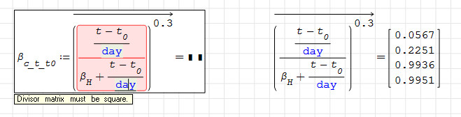

The vecterize function doesnt't work on the left, but it works on the right side.
Prestress Tension Loss Verification as per EN 1992.sm (25,09 КиБ) скачан 1758 раз(а).

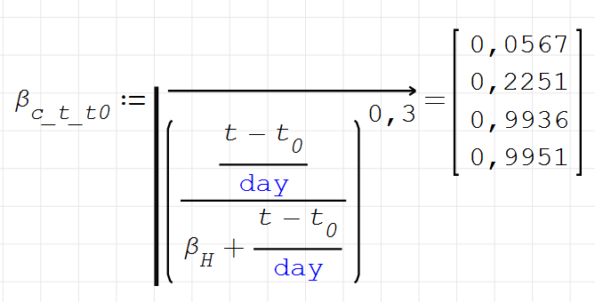

In such cases it can be solved by inserting the operation in a "line" which calculates the values before assigning them
