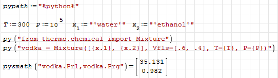

#2 Опубликовано: 25.12.2021 18:44:37
I think we can think of something. For example, it might look like this.
