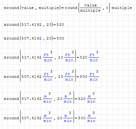

I would like to have the answer "round" to the nearest XXX. In this example, I would like an answer that gives 520 and another that gives 500
I do not want to truncate to get the 500 as I may get 589 and would like to round up
Apparently, units are part of the problem
#2 Опубликовано: 28.04.2016 15:38:05
1 440 сообщений из 2 929 понравились пользователям.
Something like this?

New built-in function, Round? Notice the capital "R"
Thanks for the work around
