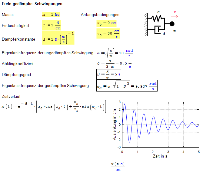

In the online gallery under Handbooks, there is a new 35 page German tutorial. It is designed along a simple engineering example and covers these topics
- Installation, activation and settings
- Text and formula regions
- Variables and functions
- Units
- Results formatting
- 2D plotting
- Editable embedded images
- Export to PDF
- Access to the Interactive Handbook
- Posting to the forum
- Further reading

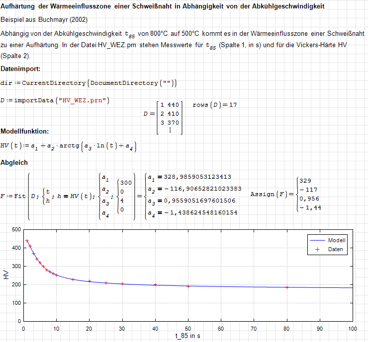

German Handbook with focus on data handling
- Matrices and vectors (does not cover linear systems and algebra in cartesian coordinates)
- data import
- Plotting with X-Y Plot Region
- Tables
- Linear and non-linear regression
I hope you like the style with single-page sections and chapterwise tables of contents.

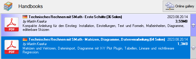

Unfortunately, when I try to download the two current manuals "Technical Calculation ..." via the plug-in administration, the message "BadRequest" always appears.
#4 Опубликовано: 18.10.2023 17:39:36
1 360 сообщений из 2 275 понравились пользователям.
As to the online gallery, I suspect these might be temporary problems due to server re-configuration on SMath side.
