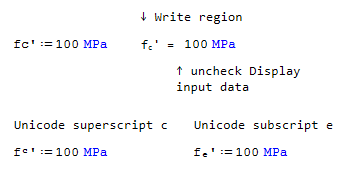

As for now, the simplest way is to use f'.c (that is widely used too).
I know ACI 318 has f.c^’, but there is not yet a way to freely mix baseline/subscript/superscript characters (also, superscript characters are only the ones available from the unicode tables).

Hi. As Davide says, there are only some few characters for subscripting with Unicode chars. This is a workaround for this case and some others:
fc'.sm (4,71 КиБ) скачан 1306 раз(а).
