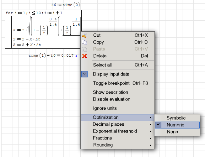

#2 Опубликовано: 25.12.2023 21:36:20
Right click to for loop.
Change Optimization to Numeric.
This had speed it to 0.017s on my pc.

I do apologize as I should have checked previous posts. I see the optimization solution in a recent post. This is definitely solving the point. Please don't fight to each other, maybe even in a non-related answer there is something to learn. Thanks to everyone for your time.

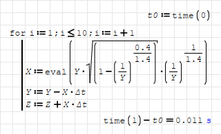

#8 Опубликовано: 26.12.2023 21:57:32
There is also eval() option.
It stores numerical value of calculation.
Without changing optimization to numeric;
sometimes it makes loops faster too.
