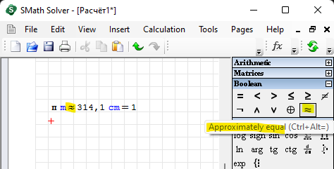

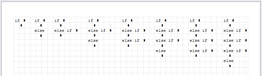

Any case of "if" statement is available now.

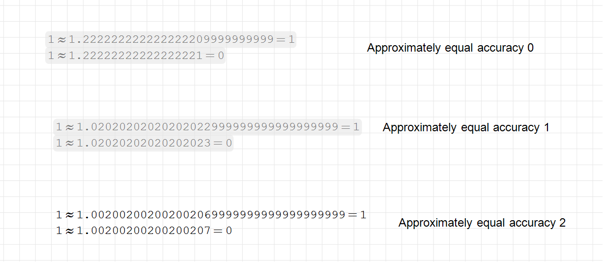

Approximately equal operator is available now (see Options dialog to set the accuracy):

I see the "Approximately equal" operator accuracy varies from 0 to 15. What does this value actually represent?
#4 Опубликовано: 20.06.2022 18:51:54
Группа: Super Administrator
Hi! It is an accuracy of the "Approximately equal" operator. F.e. if the accuracy is 0, then pi≈3, if 1, then pi≈3.1, if accuracy is set as 2, then pi≈3.14 etc.

It's more than just the decimal place precision.
approximately.sm (4,89 КиБ) скачан 1678 раз(а).

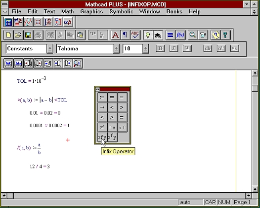

Hi. About the new approximately equal operator, another way to introduce it could be introducing a general infix operator, like in Mathcad. This screen capture is from Mathcad 6 running in Windows 3.11:
For work with units you just need to modify the rhs by abs( a-b ) < UnitsOf( a-b )*TOL (or maybe UoM). Notice that also can be a solution for another features requests, like this one about inline division: https://en.smath.com/forum/yaf_postst21614_Inline-division.aspx

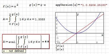

Перестали вычисляться безразмерные интегралы

Thank you. But the problem is not because of eval(). She's somewhere deeper. My f3(x) and f4(x) limits are ainterp() of the table data.

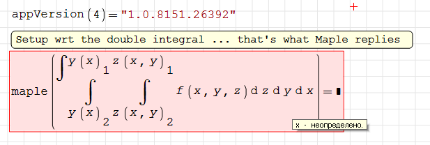

You don't provide enough maths for attempting to doctor.
You may get inspired from the double Simpson integrator.
Please, don't hesitate ... Jean

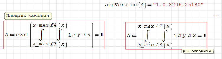

Yes, I'm reporting a bug. In version 1.0.8151.26932, dimensionless integrals with limits in the form of arbitrary functions are calculated correctly. In version 1.0.8206.25180, such integrals are not evaluated. The error "x/y - undefined" is returned.
