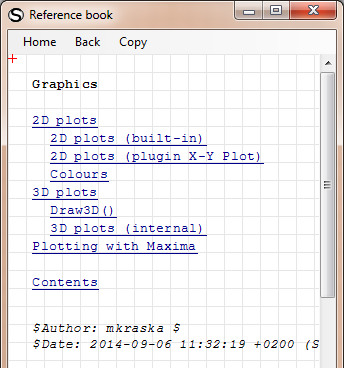

Hello Santiago,
For precise scaling/limits you have to use a plugin, such as Maxima plugin (examples) or X-Y Plot Region
A further help is inside the extension mangager (Tools > Plugins...) > Interactive handbooks; here there is the SMath Studio Handbook, that contains a Graphics section. (You have to download it, set it to use as default, then will be available from the Help > Reference book... menu)
