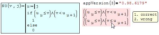

Another example:
The first A is replaced by its value, the second is not.
Not really intuitive or obvious, in my opinion.
