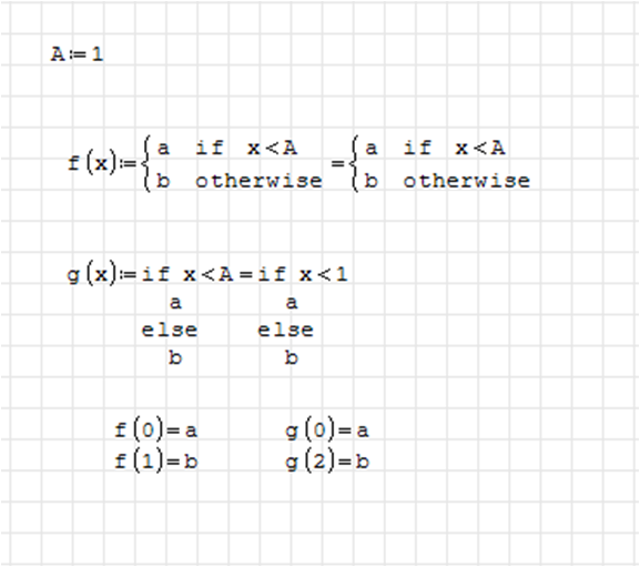

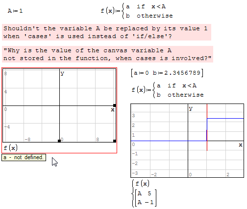

Shouldn't the variable A be replaced by its value 1 when 'cases' is used instead of 'if/else'?

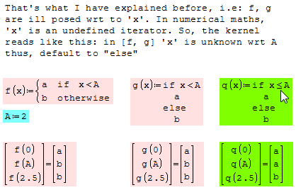

sergio 30.04.2018 04:20:00
#2 Опубликовано: 29.04.2018 20:02:30
Whatever is behind the scene, your project is ill posed..
Conditional statements must be intelligible for the numerical maths.

I really don't want to play silly games with you anymore.
I asked a simple question: "Why is the value of the canvas variable A not stored in the function, when cases is involved?"
Your answer has absolutely nothing to do with my question.
I have attended another screenshot to show the consequences of not storing the value.
cases behaves, as if there where a line operator.
cases.sm (9,81 КиБ) скачан 1178 раз(а).

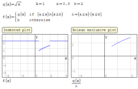

#12 Опубликовано: 30.04.2018 17:05:02
The two expressions in the screenshot in my first post are evaluated symbolically.
Can't be evaluated otherwise => nothing is defined/assigned,
thus literal evaluation ... try this
Maybe you missed my other point about appropriate condition [De Boor]
You have that in much simpler instances, not visible and falsifying project.

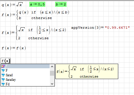

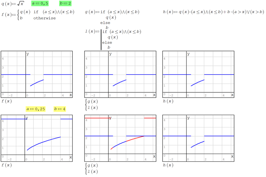

#13 Опубликовано: 30.04.2018 17:28:50
Martin_B
Martin_B
22 сообщений из 84 понравились пользователям.

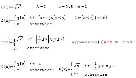

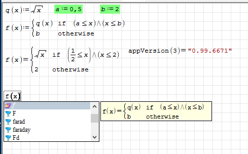

The values of a, b and q(x) are not stored in f, as you can see in the following screenshot.
And by assigning f to f they are!
And that seems to me like a kind of invisible line operator, because it behaves like one.

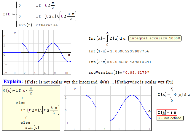

#16 Опубликовано: 30.04.2018 18:46:22
The all thing is about what comes from conditional.
For instance: the integration operator needs an analytical integrand.
From if/else, integrand is not scalar vs if/Otherwise.
Simple things turn nightmare ... many same in Mathcad.
Plots are same but not integration.
#17 Опубликовано: 30.04.2018 20:14:58
... for this particular integration example, it is necessary and sufficeinet
to transform the domain of if/else [ infinitesimal ...] in scalar domain.
Here, we have it already done in term of integration.
Integrate Discontinuous [Nuance].sm (13,02 КиБ) скачан 1007 раз(а).

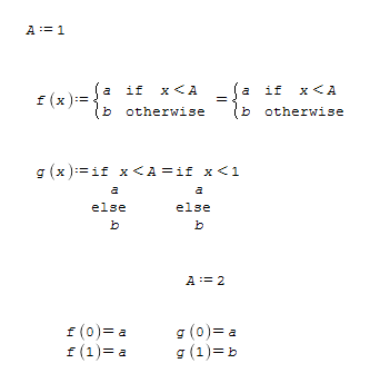

#18 Опубликовано: 01.05.2018 10:04:25
Arie
Arie
I do not understand. The cases function works perfectly.
The difference comes when the value of A changes after the definition of f(x) and g(x).
For g(x) the original definition of A:=1 remains. However, for f(x) the value of A changes.
cases_ok_alyles.sm (5,57 КиБ) скачан 1144 раз(а).
#19 Опубликовано: 01.05.2018 17:53:43
Arie
Arie
So I believe I understand what is going on a little better.
I've attached the same .sm file as before only this time with break points. If you open the debugger window and step through you can see exactly what happens.
When f(x) is defined it sets f(x) equal to cases(a,xNote when g(x) is defined it will step through and evaluate the if() function and each individual input parameter (xThe cases() function within f(x) doesn't actually evaluate until it is called with f(0).
This is why, as you described earlier, if you set f(x):=f(x) you finally get the result that you want, because at this point it will finally evaluate cases(a,x
I'm not sure if this is a plugin issue or if this is just how SMath handles it's plugin interface.
cases_ok_alyles_with_breakpoints.sm (5,57 КиБ) скачан 1162 раз(а).
