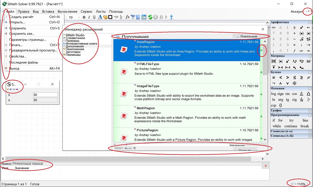

I have a high DPI screen, so there are some issue with the scaling. I know about changing the settings of the exe file, which were described, last time, in the topic "Beta SMath Studio 0.99.6965", but this, as I understand it, is a temporary solution.
1. Some elements of the Solver's forms remain without scaling, although most elements scale normally.
2. All elements of the Writer's toolbars without scaling.
Screenshot was reduced to 40%
