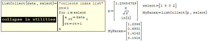

Get + from much less.
ListCollect(■,■) has no limit in construction.
