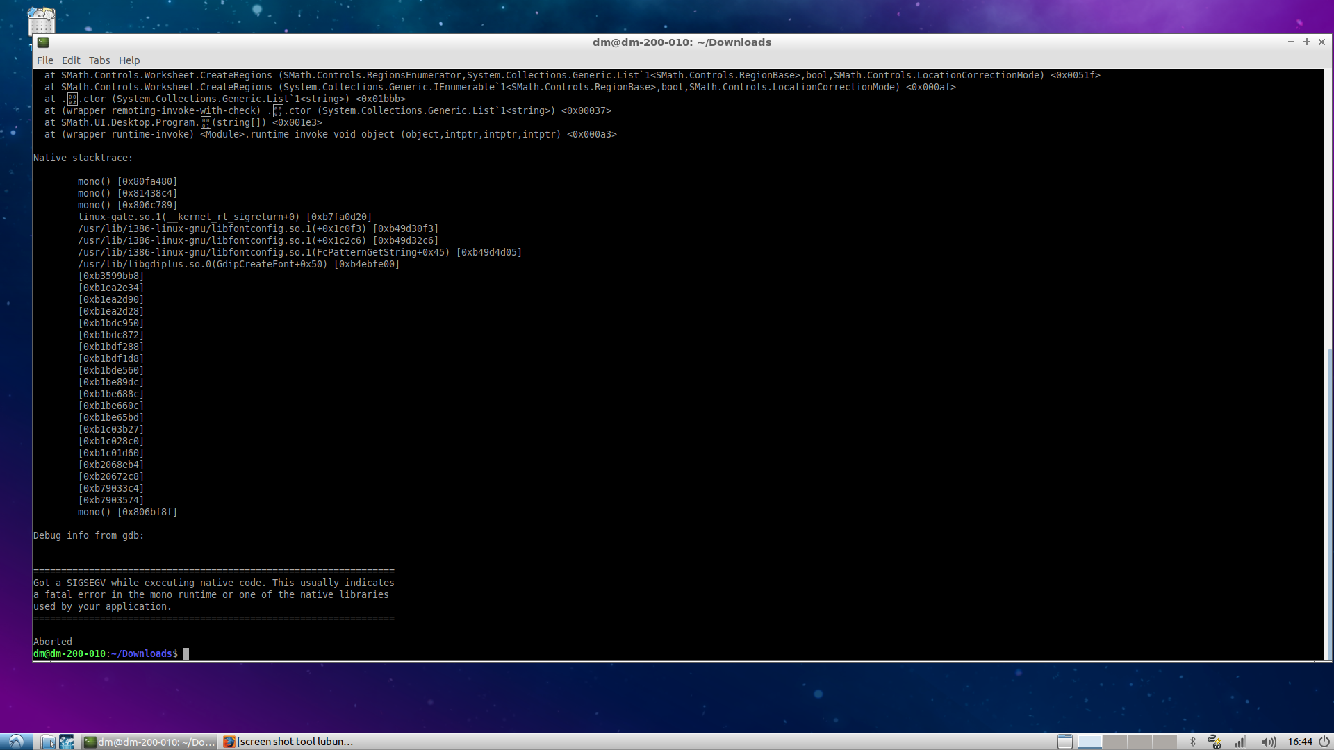

Andrey Ivashov 15.10.2018 11:39:00

#10 0x00007fe71d60e1d8 in  ()
#11 0x0000000000000000 in  ()
Got a SIGSEGV while executing native code. This usually indicates
a fatal error in the mono runtime or one of the native libraries
used by your application.
Aborted

dmmartinez
dmmartinez
Just installed Lubuntu 18 LTS on an HP Stream mini and wanted to install SMath (0_99_68658). Installed mono and double clicked the .exe and is tries to load, then nothing. Tried in terminal in mono. Got a set of errors about missing font library. Tried again to do a scree capture and had a slightly different error. Attached screenshots. Also said: debug info from gdb:
Показать спойлер
