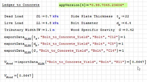

It works for me. Close Excel file and Recalculate the SMath file.
SMath displays an error if Excel file is open.

It worked when I closed both Excell and Smath and opened SMath again.
but the problem now, is when I change the inputs, say ts=22mm the output (calculated value from excel) does not update, which is essential in a sheet like that.

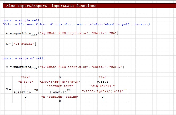

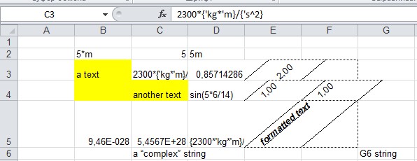

I have a problem when importing numbers with units of measurement.

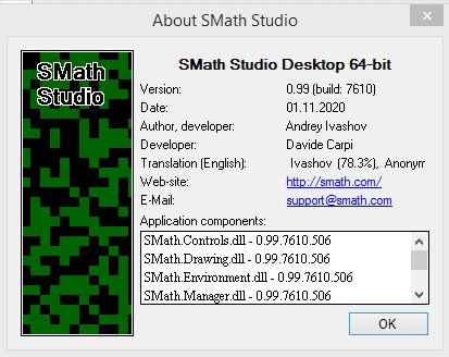

Using SMath Studio Desktop v 0.99 build 7610 with XlsxImportExport 1.3.6996.39330
When I try to import a number with units of measurement from xlsx document, like for example: 2300 * {'kg *' m} / {'s ^ 2} in SMath Studio, I get string variable as a result: "2300 * {' kg * 'm} / {' s ^ 2} ".
How can I get number with units of measurement type variable, like this image1.png
Source document: my SMath XLSX input.xlsx
Example, before recalculation:
Example, after recalculation:

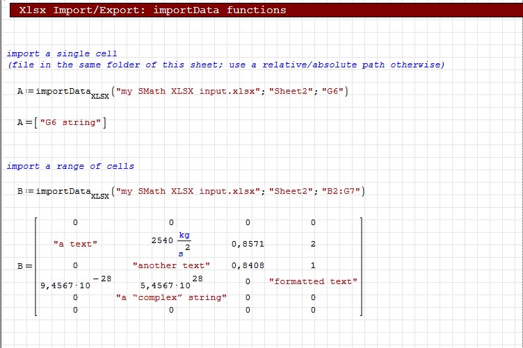

Hi. You can try to apply this algorithm, and see if you are satisfied with its result:
