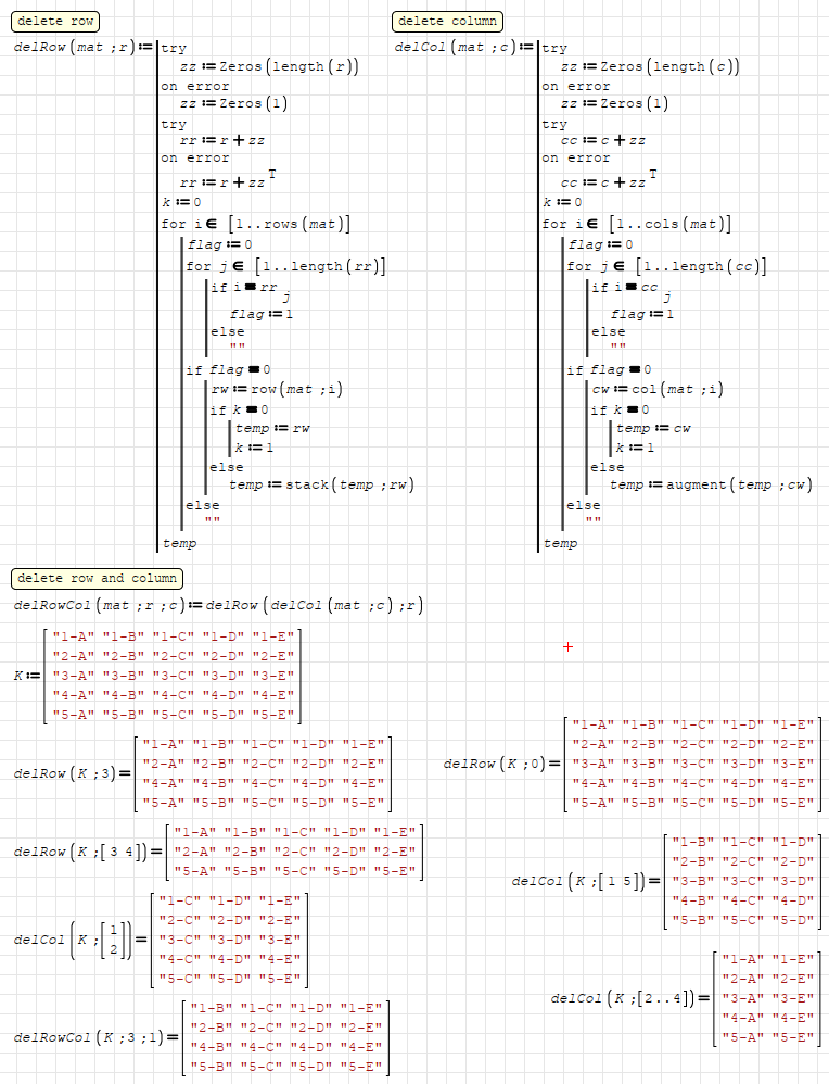

Some functions for row and column deletion.
For row and column functions accepts horizontal and vertical vectors, range(2) and range(3), numbers.
No need to convert anything during input, and exceeding and subceeding values not be removed.
delete_rowcol.sm (21,39 КиБ) скачан 1191 раз(а). (old method)
delete_rowcol.sm (15,58 КиБ) скачан 1207 раз(а). (new and faster method)

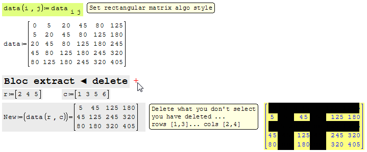

Otherwise useful ... you delete what you don't select.

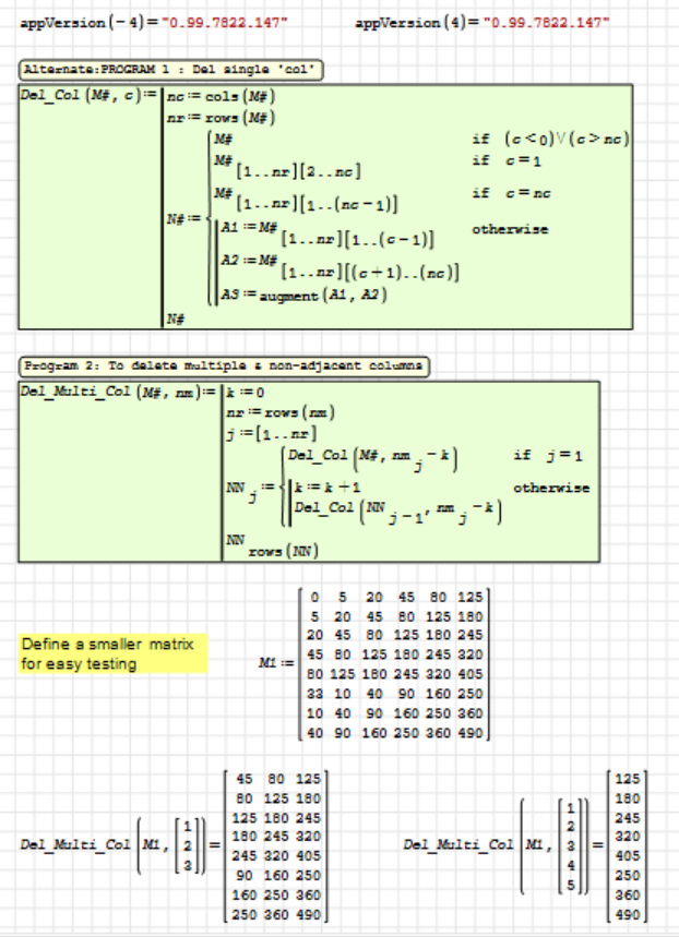

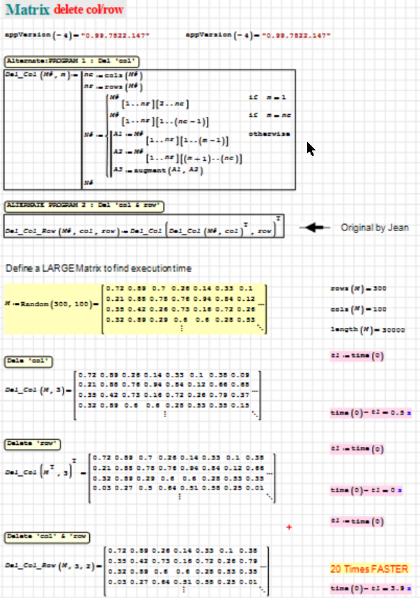

Alternate program. Very fast on large matrix.
Jean's program very helpful. Thank you Jean
New_Matrix_Delete [col_row].sm (24,06 КиБ) скачан 1104 раз(а).

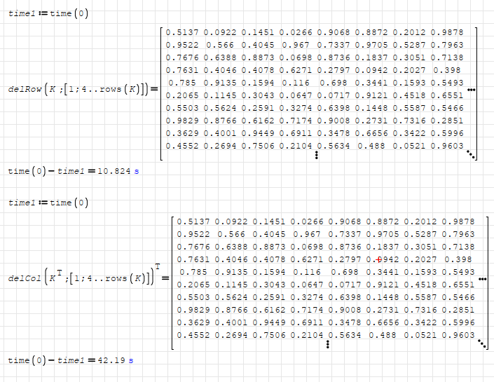

I tried your solution and found out it is faster with single row or single column removal. Good job.
And also found out transpose method is way much slower if I use ranges or matrices for input.
That method is not fast enough and not a good method when you use vectors of columns or rows for removal.
So I have combined your solution with mine, a fast and feature-full method is born.
New file is added in first post.

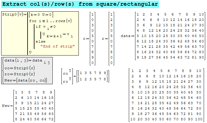

From square/rectangular matrix algo style do all at will.
1. delete cols & rows in any shuffled ways.
2. conserve selected rows deleted of 'j'.
3. conserve selected cols deleted of 'j'.
Hopefully, no red in your SS version !
Thanks, be good ... Jean.
Utilities Matrix Minor [col_row] ADVANCED OTHERWISE Copy.sm (21,58 КиБ) скачан 1097 раз(а).

A revised version, to delete multiple non-adjacent columns.
Faster on large matrix than my last example in post #3.
New_Matrix_Delete [col_row]_R2.sm (41,9 КиБ) скачан 1065 раз(а).
overlord 03.06.2021 21:45:00, Alvaro 02.06.2021 17:53:00

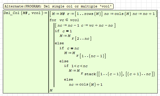

Hi Amarasekera. Please try this other version, which works for single column values or column ranges.
New_Matrix_Delete [col_row]_R2.sm (38,79 КиБ) скачан 1053 раз(а).
