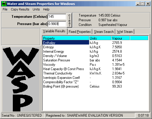

#27 Опубликовано: 08.01.2017 12:41:22
The user also asked for speed of sound and isentropic exponent functions. Is there a way to help him?
"WASP" is freeware for 10 minutes use, unlimited sessions.
"WASP" from "Katmar". all properties are tabulated per T(°C) or P(abs).

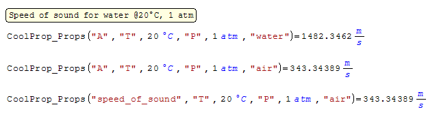

#28 Опубликовано: 08.01.2017 15:58:05
As for the speed of sound can be accessed using "A" or "speed_of_sound"

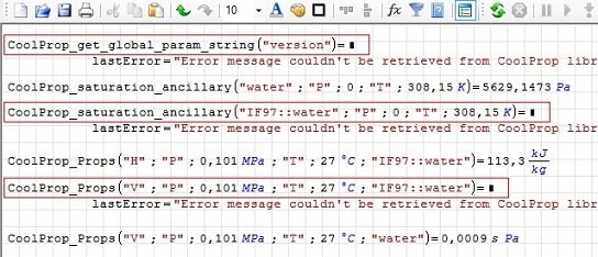

#34 Опубликовано: 22.12.2017 21:39:02
Aleksey
Aleksey
1 сообщений из 2 понравились пользователям.
CoolProp_get_global_param_string("version"
lastError="Error message couldn't be retrieved from CoolProp library (buffer size issue?); the second try returned: "
what's the problem?

#39 Опубликовано: 27.12.2017 12:47:24
don't working on
Win10x86Pro, Win10x86Educ, Win7x86Pro
Thank you, reproduced. Something goes wrong with the wrapped 32 bit library (the coolprop dll returns both the correct result as well as an error code, hence the errors shown).
