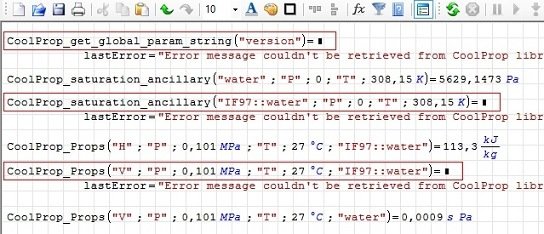

#21 Posted: 10/26/2016 5:07:40 AM
Also, no dynamic assistance is available. Though disabling the plugin doesn't help.
Dynamic assistance is enabled in the program's options?

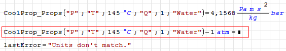

#23 Posted: 10/26/2016 8:14:41 AM
Hello Jean, according with CoolProp documentation "Q" stands for "Mass vapor quality", thus 1 is 1 mol/mol
Thanks Davide for "unitless Q" and the link to CoolProp Wrapper

#24 Posted: 10/26/2016 12:49:17 PM
Here's what I see:
Try now
Mike Kaganski 10/26/2016 5:00:00 PM, Radovan Omorjan 10/26/2016 6:18:00 PM

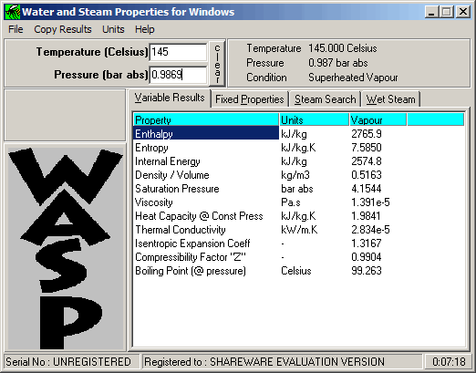

#27 Posted: 1/8/2017 12:41:22 PM
The user also asked for speed of sound and isentropic exponent functions. Is there a way to help him?
"WASP" is freeware for 10 minutes use, unlimited sessions.
"WASP" from "Katmar". all properties are tabulated per T(°C) or P(abs).

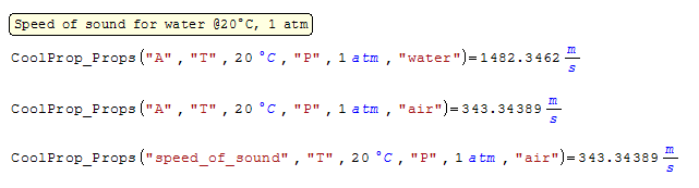

#28 Posted: 1/8/2017 3:58:05 PM
As for the speed of sound can be accessed using "A" or "speed_of_sound"
For the isentropic functions I googled "isentropic coolprop" and there is something but it is not my field, maybe Mike can give some hints.
