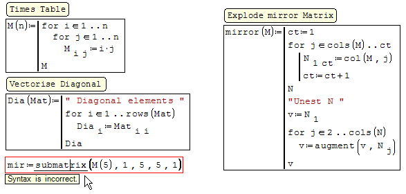

Smath does not support reverse cols order in "submatrix".
Alternately, here is the module. Read more in the attached.
Utilities Matrix Mirror Exercise.sm (19,08 КиБ) скачан 1332 раз(а).

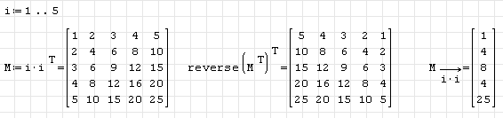

You even don't have to wait for the vector indices, at least for the mirror.
See here
The mirror implementation is straightforward to understand (transpose, reverse, transpose)
The diagonal is a nasty indexing trick, which is that far from paper and pencil notation that it can't be recommended unless you want to obfuscate your algorithm (then best use excel). You just square the row/column index range elements to access the diagonal elements in linear indexing.
This, however, uses the vector index feature.
See here

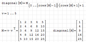

frapuano 09.09.2016 14:23:00
WroteThe diagonal is a nasty indexing trick, which is that far from paper and pencil notation that it can't be recommended unless you want to obfuscate your algorithm (then best use excel). You just square the row/column index range elements to access the diagonal elements in linear indexing.
diagonal(M):el(M,(range(0,(rows(M)-1)))*(rows(M)+1)+1)
