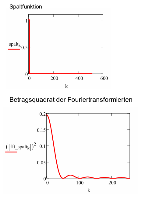

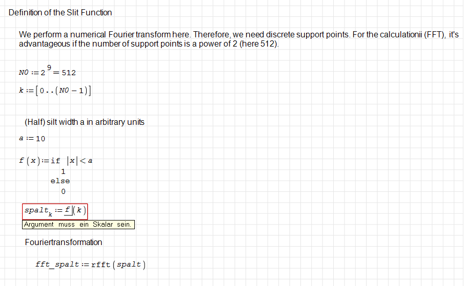

I have a Mathcad Document about Fourier transform that I want to translate into SMath.
I already dowloaded the FFTPack plugin. I used the same functions from the Mathcad document which doesn't work in SMath.
I tried a bit but nothing is working. The error message says "The argument must be a scalar."
I attached screenshots from my SMath document and the original Mathcad document.
Does anyone have an idea or a helpful tip?

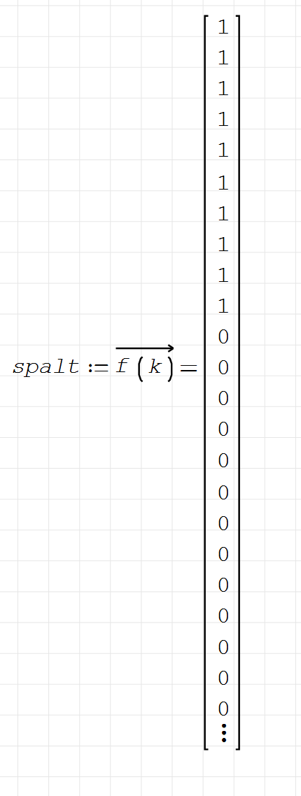

try to construct the vector like this
Показать спойлер
Caro 15.05.2026 07:01:47
#4 Опубликовано: 15.05.2026 07:07:59
Caro
Caro
1 сообщений из 13 понравились пользователям.
Thank you! That worked and the error message is gone.
