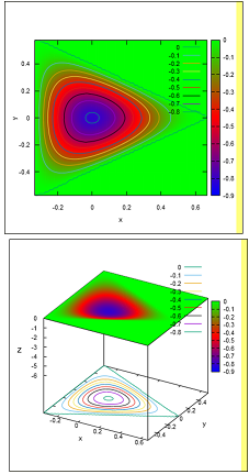

#7 Опубликовано: 24.01.2018 16:02:51
I tried to use the plugin Maxima
PlateMaxima.sm (143,87 КиБ) скачан 1530 раз(а).
Andrey Ivashov 24.01.2018 16:37:00, frapuano 24.01.2018 19:43:00
#8 Опубликовано: 25.01.2018 23:52:49
Thanks Ber7, I love those 3D, though it will never beat Mathcad 8... 11.
On my own, I published several times more than the entire Mathcad Community.
I don't miss them in Smath 6179, why ? purely useless for the Engineer.
They are just for the Gallery [Tom G. would say Peanut Gallery].
We are just waiting for a stable Smath version delivered with Maxima plugin
and more of the possible plugins. Scilab looks far superior to Maxima ?
