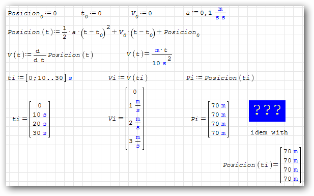

vector incorrect?
vector incorrect? - The values of the Pi vector, calculated for the previously defined function are invalid - Сообщения
#1 Опубликовано: 16.08.2018 09:48:04
Puma3D
Puma3D
However, by analyzing the individual values
any solution?

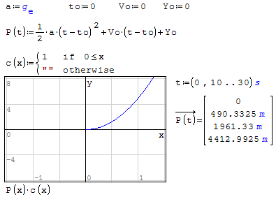

You must use the "vectorize" function to execute the operation element by element of the vector "ti"

any solution?
#5 Опубликовано: 16.08.2018 13:42:30
Cannonball project ...
Maths Cannonball Copy.sm (28,19 КиБ) скачан 1345 раз(а).
