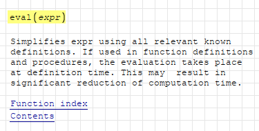

Is there a reason why Dy is within in eval()?
eval() makes computations faster most of time.
Very minor times, may have no effect or slows the calculation.
It would be wise to choose where and when to use it.

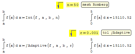

1. as well, you can recast the function name.
That's what I meant by recast, last page of the attached.
Cheers ... Jean.
Integrate AdaptiveRombergKernel FIRST Tool.sm (152,26 КиБ) скачан 1227 раз(а).
#25 Опубликовано: 27.12.2021 17:19:04
