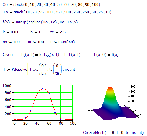

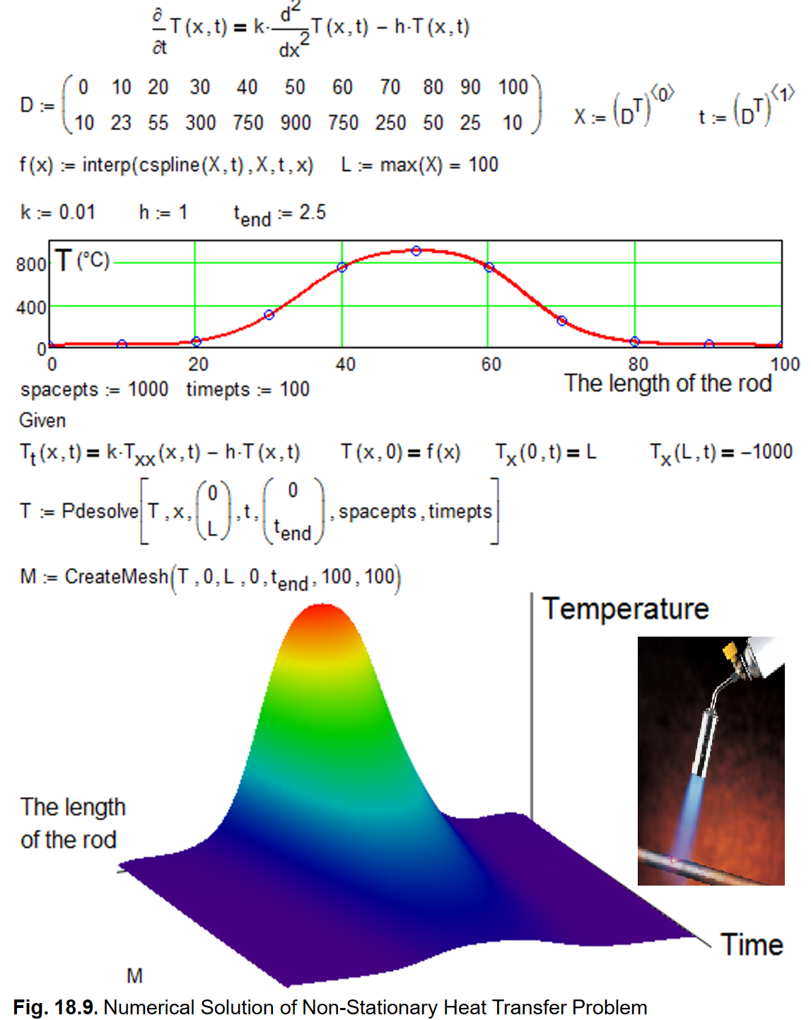

We heated the rod in the flame of a burner.
How will it cool down?
Non-stationary mode!

Wrote... And what about the ICs?
We must use one numeric not symbolic method!

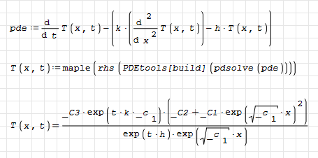

Using maple, you can try to use a maple "component" or a maple plot, which gives more flexible access to maple structured functions.
Also, there are some numerical procedures for pde's in Maxima.
Notice that in Mathcad the border conditions for δT(x,t)/δx are not considered for obtain the solution.

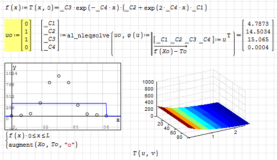

With SMath, you can try to adjust the curve choosing good guess values in the yellow vector.
pdesol_num.sm (14,78 КиБ) скачан 1262 раз(а).
