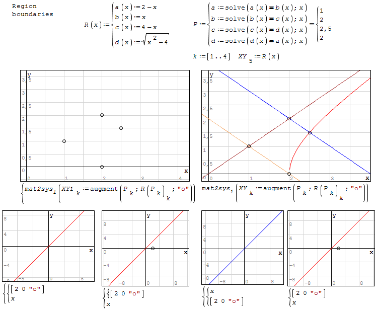

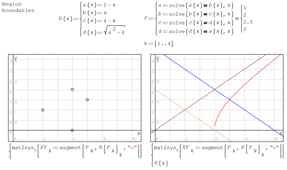

Hi. In the attached, can plot points and functions, but not both in the same plot.

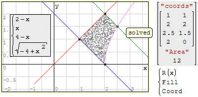

#2 Опубликовано: 16.11.2018 17:27:11
The old style works otherwise.
You can fill the region of integration.
Double Integral.sm (16,39 КиБ) скачан 1207 раз(а).
Double Integral FillRegion.sm (17,83 КиБ) скачан 1174 раз(а).
#3 Опубликовано: 17.11.2018 06:40:28
The behaviour of arguments in nested lists seems to be unpredictable, at least I don't see the rule.
Thus, re-arranging objects works but I don't know why.
Double%20Integral_Kr.sm (11,48 КиБ) скачан 1387 раз(а).

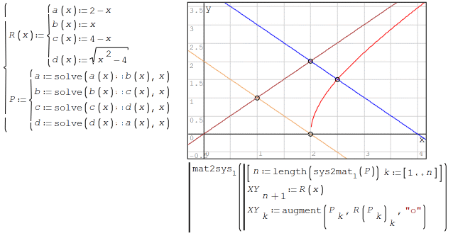

#4 Опубликовано: 17.11.2018 11:46:20
1 125 сообщений из 1 798 понравились пользователям.
Hi Martin. Thanks for the tip. I guess that I take this form, from you suggestion:
#5 Опубликовано: 17.11.2018 18:18:39
... personally: I prefer the more conventional form.
The example in view may fail in other instance(s).
3 in one: functions, solutions, fill-in region.
X_Y Plot wisely [Solve] Boundary.sm (39,51 КиБ) скачан 1043 раз(а).
