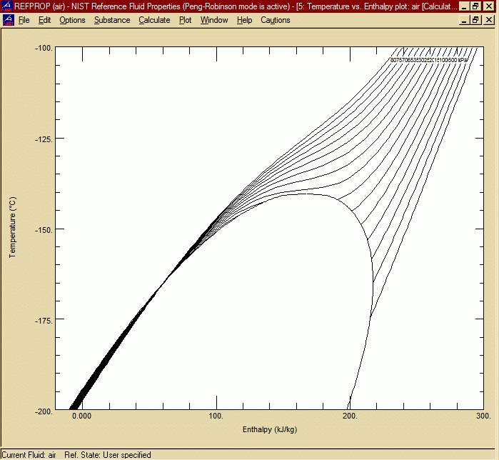

There are not "not yet implementing" or bug in CoolProp. If can't work in this region is because is very difficult to solve the inversion: For each enthalpy there are two valid temperatures in the phase line. Which make unstables (when not imposible) some algorithms. For this case the system can't be determined with the usual two intensive or extensive properties states, and need 3 or, inside the region, one intensive an the quality. See the attached diagram.
Or here, the diagrams for PR in mathcad: https://www.ptcusercommunity.com/message/424574#424574

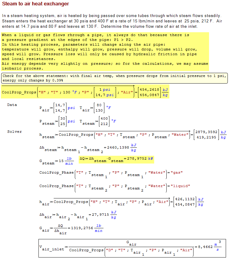

Mike Kaganski
Mike Kaganski
MassAndEnergyInCV_Mike.sm (20,83 КиБ) скачан 1351 раз(а).
Edit: I see that the air flows outside the tubes; however, the said holds true: the pressure drop across the starting and ending points cause air flow; this pressure drop may be ignored for the task. The losses that are ignored here, constitute much higher indeterminacy.

Alvaro 29.05.2016 04:43:00
#24 Опубликовано: 29.05.2016 04:44:48
Yes, thanks, that's correct. Can be obtained also with mixing models: IG for air, steam props for water.

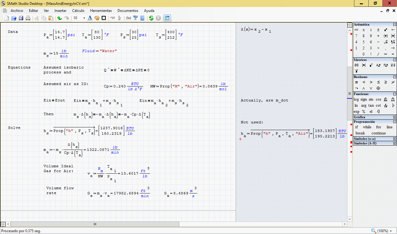

#25 Опубликовано: 29.05.2016 04:57:09
Mike Kaganski
Mike Kaganski
Edit: I'm sorry, uploaded some utter garbage. Updated file.
Air in piston-cylinder with stops.sm (16,68 КиБ) скачан 1409 раз(а).
С уважением, Михаил Каганский

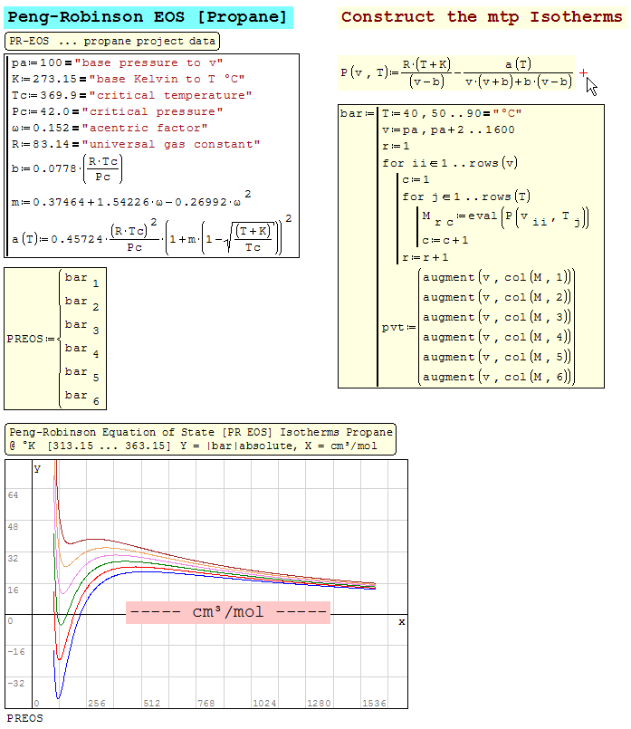

... read a bit more in the work sheet.
PR EOS.sm (44,14 КиБ) скачан 1344 раз(а).

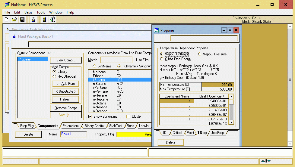

Hi Mike. For this is put images from RefProp about the ref states. Hysys use another method, and have H(T), gibss free energy and vapor pressure constants which uses in conjuntion with the PR EOS.
Attached, a table with some other values for critical values and Cp of ideal gas.

Some notes: what in the literature is alpha^2, in my ws is alpha. Phi isn't the fugacity, which is evaluated as f=P*exp(L). Is the conclusion of take the phrase "minimun fugacity provide most stable z", i.e. the manipulation for obtain the simplest expression which minimize f (hope errorless). Remember that in the mixture phase region, T,P are not independent variables, this is, with T,P only can't determine the thermodymamic state. You must to provide another information, like other state variable or the quality (x). For this reason is why I output only one z: which minimize the fugacity. If for any state you output two z I guess that is useless, that´s only for mixture phases region and in that case can´t use T and P, must to use (in the practice) x.
In my mathcad ws (not implemented yet in smath) I output also for vf, hf, uf, sf, vg, ... etc (f liquid phase, g vapor, in german). This is equivalent to f for x=0, g for x=1. I use Lee-Kesler eq for get the aproximate point in the change phase line, and root for the value, but I'm not convinced of this.
