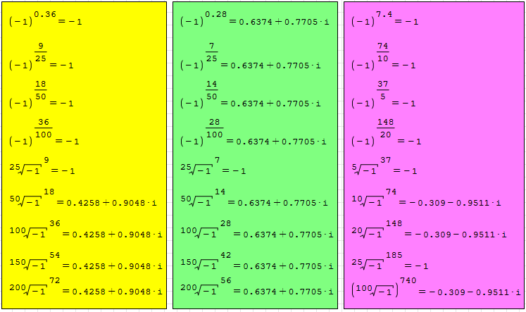

There is a bug I have encountered.
The result shouldn't be -1 or 1.
Result are correct for some not for others.
But we can't know when it is correct or not.
sergio 08.11.2021 14:26:00, NDTM Amarasekera 09.11.2021 14:53:00, Davide Carpi 11.11.2021 10:07:00

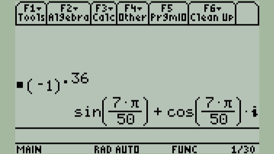

You are wrong.
Exponentiation of -1 or i has mathematical meaning.
What means is your calculators don't have rectangular form.
I don't care if it has practical usage or not.
Mathematics has it, period.
TI-89 Titanium:
