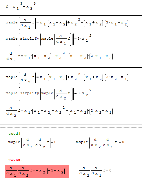

Look at this please
[MATH=eng]f:el(x,1)^3+el(x,2)^3[/MATH]
This is correct:
[MATH=eng]diff(diff(f,el(x,1)),el(x,2))=0[/MATH]
But this is obviously wrong:
v0.95
[MATH=eng]diff(diff(f,el(x,2)),el(x,1))=-el(x,2)*(-1+el(x,2))[/MATH]
It seems that is still present in v.90 as well:
v0.90
[MATH=eng]diff(diff(f,el(x,2)),el(x,1))—-(-1+el(x,2))*el(x,2)[/MATH]
In v0.89.8 you will get the right answer - zeros for both mixed derivatives.

I confirm!
seem related to the symbolic simplification (see the attachments)
regards,
w3b5urf3r
derivatives_debug.sm (36,92 КиБ) скачан 1309 раз(а).

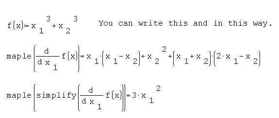

#4 Опубликовано: 08.10.2012 19:26:09
Here some (probably) related issues.
best regards,
w3b5urf3r

It's the way SMath handles/prioritizes ASCII characters. I ran into a similar issue with MathCAD. In this case, the second variable of "x" (in the equation) has to be the first variable of the first derivative as shown in w3b5urf3r's screen shot.

Yes, I know. Thank you . I did it on purpose, just to put the stress that maple did it right.
