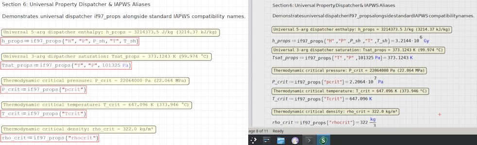

Many functions for water and steam properties are exposed. Library is unit-aware and outputs in standard SI units.
OS agnostic
Archive contains .zip plugin, .sm artifact, detailed documentation and source files
The problem I am facing is with few functions which work in my Linux but do not work in Windows. Perhaps someone can sort it out
IF97_Steam.7z (118,9 КиБ) скачан 75 раз(а).
OS agnostic

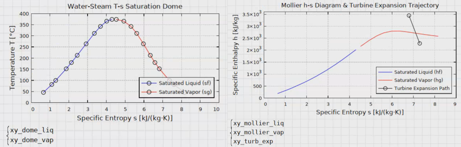

francesco rapuano 17.10.2026 08:26:01
Completely updated OS agnostic plugin
Check /dist/*.zip for ready to use plugin
Code is hosted at github https://github.com/defencedog/smath-devel/tree/main/plugin/IF97_src_win
PDF: https://github.com/defencedog/smath-devel/blob/main/plugin/IF97_src_win/examples/if97_steam_tables.pdf
