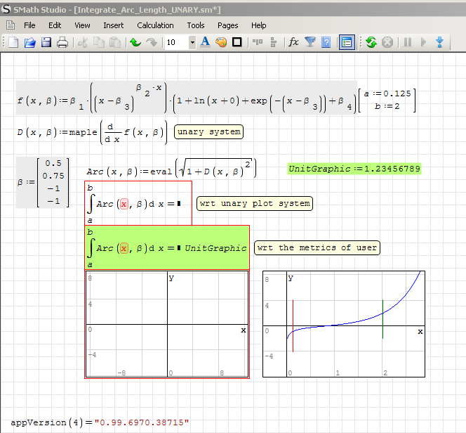

Hi Jean,
in which version did you prepare this example?
I use the last beta version, but I get a error 'x-not defined'
Thank you and best regards,
Andrey

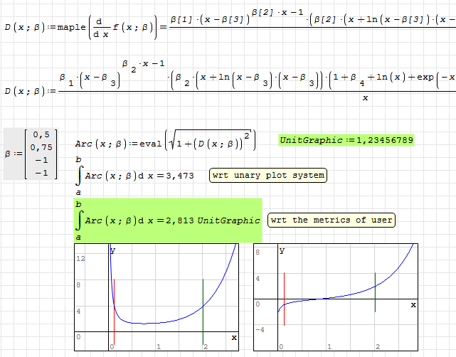

#3 Опубликовано: 03.02.2019 12:25:36
It is probably because MapleTools returns β[#] instead of el(β,#)

#5 Опубликовано: 03.02.2019 16:45:38
"It is probably because MapleTools returns β[#] instead of el(β,#)"
MapleTools updated. Issue fixed.

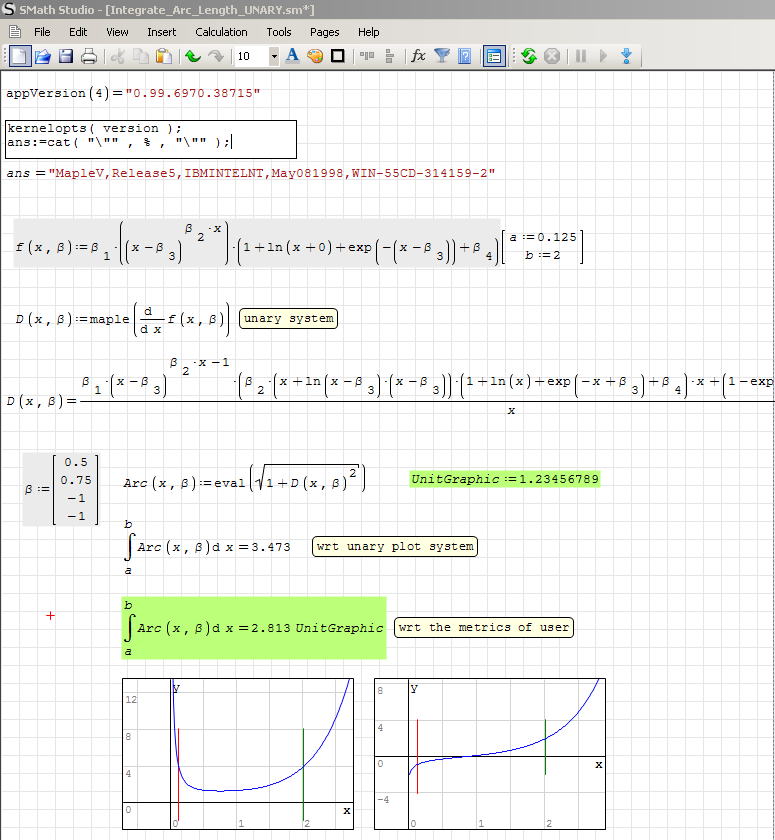

#6 Опубликовано: 03.02.2019 22:05:25
... from Smath 6179.
As Davide points out, your latest freaks Maple !
