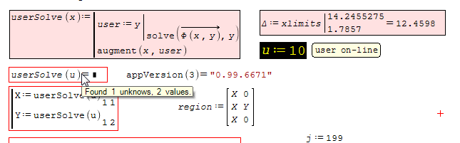

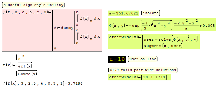

Interesting the implicit/recursive discrete solver.
Few more techniques/tools in these two Smath documents.
Contour SOLVE [user].sm (46,96 КиБ) скачан 1061 раз(а).
Contour SOLVE [at(2)].sm (174,57 КиБ) скачан 1079 раз(а).

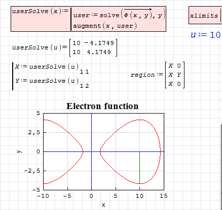

#2 Опубликовано: 28.06.2018 08:42:30
Few more techniques/tools in this Smath document.
... lobes added
Contour SOLVE [user].sm (61,45 КиБ) скачан 1041 раз(а).

Hello Doctors ! please help Radovan.
The error message does not indicate an error in the transmission.
Please, re-download these [3] that have same solver or otherwise.
Project Solve Ejector.sm (19,58 КиБ) скачан 1304 раз(а).
Contour SOLVE [at(2)].sm (172,45 КиБ) скачан 1056 раз(а).
Contour SOLVE [user].sm (65,84 КиБ) скачан 1071 раз(а).

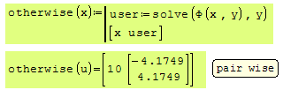

#5 Опубликовано: 28.06.2018 14:38:11
Hello Jean,
I just removed at(). Is this all right?
#6 Опубликовано: 28.06.2018 20:23:00
Hello Jean,
For sure, more than correct as your solve(,,) gets pair wise solutions.
Yes, the lobe is symmetric around the 0 datum.
#7 Опубликовано: 28.06.2018 21:08:22
... now I get pair wise solutions. But not augment !
