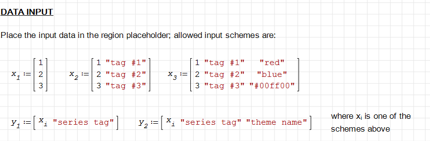

you have to add a second column in the data matrix with the names, otherwise a progressive number is used by default.
From the documentation...

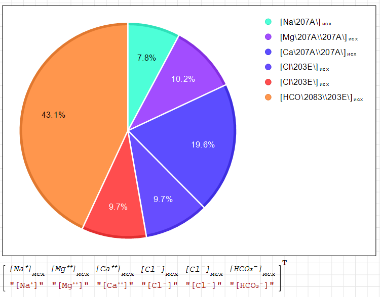

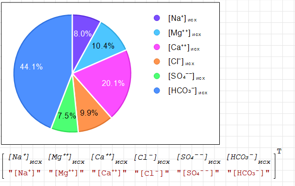

BTW I see there is not yet text decoding, I'll fix it soon.
Fixed, plugin update released.
