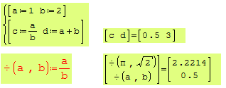

Is there any way to present division on the same line and not as a fraction? For example in Mathcad:

Is there any way to present division on the same line and not as a fraction ?

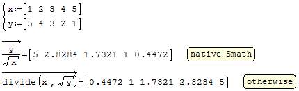

Answer is NO, Smath does not have native ÷ operator
More productive from infix algo style utilities,
for infinite in-situ command line.
