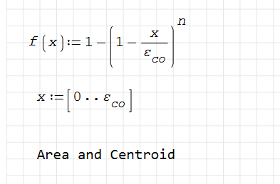

How to find area and centroid
question_20230711.sm (2,88 КиБ) скачан 1444 раз(а).

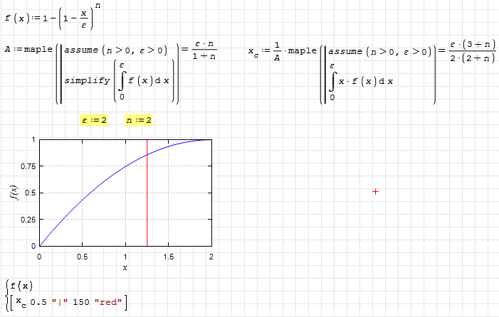

Ac.sm (6,17 КиБ) скачан 1411 раз(а).

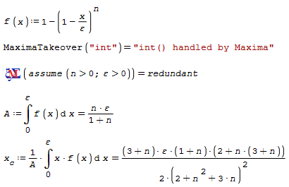

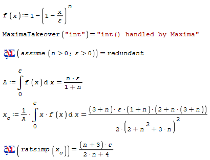

Maxima is a bit lazy with simplification...
Ac.sm (7,08 КиБ) скачан 1401 раз(а).

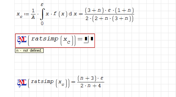

why can't i do right that?
what's the problem?
