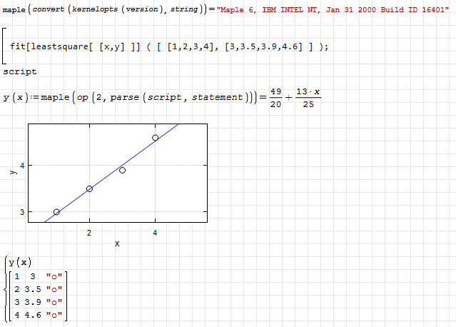

It is possible to use this function, but it is difficult. To do this, you need to include the stats package in the with.inс file. By default, not all packages are included in the plugin and you must manually specify the required ones in the plugin folder (bin\with.inc):
with(linalg):with(inttrans):with(plots):with(stats):
Unfortunately, the Maple syntax is difficult to replicate in a document, so the ability to use the symbol engine is limited. I'll see if I can somehow use this solution with vectors from the document. Now I recommend using alternative solutions, which I hope will be offered soon.

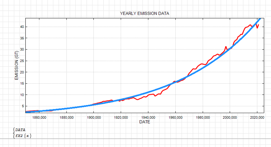

CBG
CBG
Hello
I think you can use the Least Squares algorithm to fit the data.
CLIMATE CHANGE WORKING_CBG.sm (35,53 КиБ) скачан 1371 раз(а).

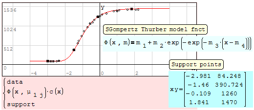

#14 Опубликовано: 05.06.2023 18:32:31
... Smath Thurber fit
Dear Uni I tried to duplicate your example after adding with(stats) to the plugin\bin\with.inc Unfortunately I seem to do something wrong. Could you assist me? Thanks in advance. I have added my attemptMapleFitTest.sm (3,75 КиБ) скачан 1293 раз(а).

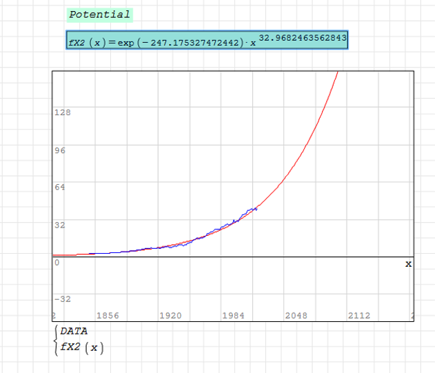

Hi Reg. The solution proposed at the post #4 in the file { CLIMATE CHANGE.sm (19,28 КиБ) скачан 1545 раз(а). } only uses an standard SMath plugin, for al_nleqsolve .
Click to enlarge
I assume that means I must write my own since nothing offered so far gives a good fit like the Mathcad exponential fit. ...
In this graph, the solutions of SMath, Maxima and Mathcad are compared. SMath's solution seems as valid to me as Mathcad's.
Click to enlarge
