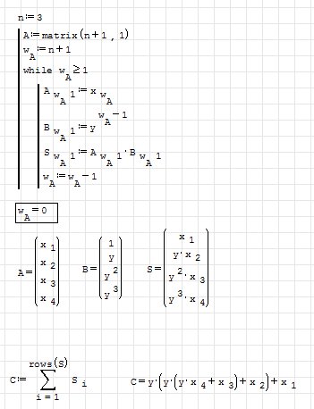

Ok. I thought a little bit, and i think that this should do the trick
Risen_indices - wiki_upload_file
Although still does not have a "nice" (transparent) appearance. Perform calculations correctly.
Something simpler. I went to far with "n" variable.
Risen_indices_2 - wiki_upload_file
Best regards. Rafal
