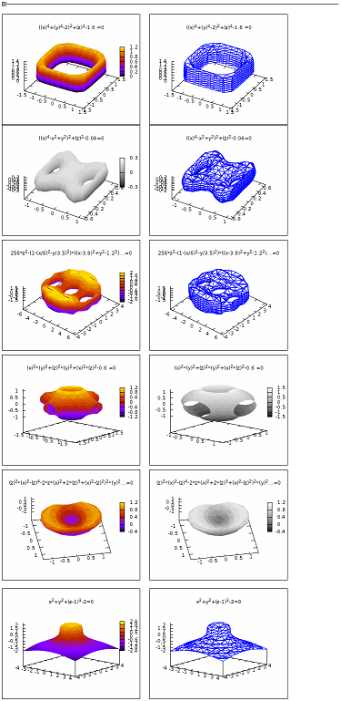

#13 Опубликовано: 06.02.2018 03:56:52
Fridel Selitsky
Fridel Selitsky
Implicit surfaces in Maxima
ImplicitMaxima.sm (363,82 КиБ) скачан 1337 раз(а).
frapuano 06.02.2018 04:34:00, Martin Kraska 06.02.2018 04:59:00, Radovan Omorjan 06.02.2018 06:22:00

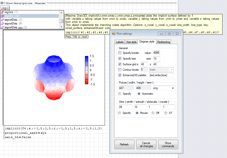

#14 Опубликовано: 06.02.2018 05:06:49
Nice examples!
Just some remarks for those who want to play around with Maxima Draw.
  • Instead of Image region with Draw() command you can use Maxima Draw3D region with interactive zoom, rotation and resize and a settings dialog.
    Insert-> Maxima-> Draw3D
  • The performance isn't overwhelming, as the image is recalculated for each interaction.
  • The snippet "draw" provides help texts for the available draw commands and options.
  • Follow the link in my signature to see how to configure SMath with Maxima.
ImplicitMaxima_Kr.sm (492,51 КиБ) скачан 1372 раз(а).
Вячеслав Мезенцев 06.02.2018 06:15:00, Radovan Omorjan 06.02.2018 06:22:00, frapuano 06.02.2018 10:28:00, Fridel Selitsky 06.02.2018 05:08:00

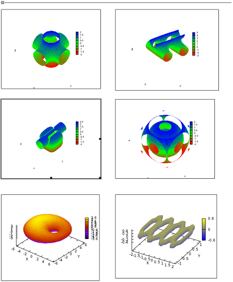

#15 Опубликовано: 21.02.2018 16:41:18
Fridel Selitsky
Fridel Selitsky
Continuation:
MaximPlus1.sm (237,91 КиБ) скачан 1298 раз(а).
frapuano 21.02.2018 18:56:00
