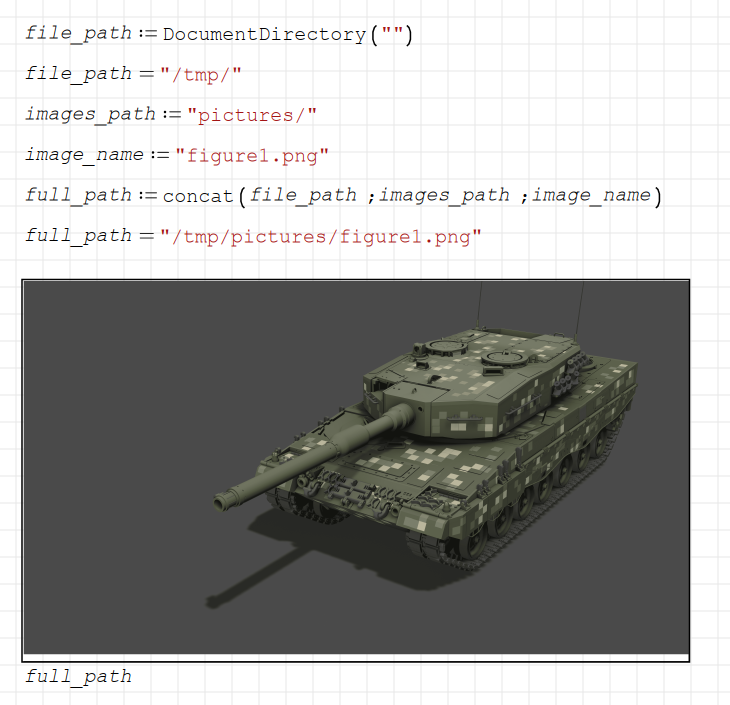

#2 Опубликовано: 14.07.2026 19:31:55
Best and fastest way is to embed pictures in to smath file.
But this method will make your file very big depending on pictures.
Another way is to use DocumentDirectory() function.
Keeping your pictures out of smath file and relying on dynamic paths is available.
See the example below
Отредактировано 14.07.2026 19:32:41
Alvaro 15.07.2026 11:15:52

If the image is static, then just paste it to the canvas and resize as required.
If the image may be externally modified, the way shown above is convenient.
If you want to edit the image in paint or any other editor, then you might use the image region as for external files, while keeping the placeholder empty. Then you can set the file format in the context menu and launch an editor.
