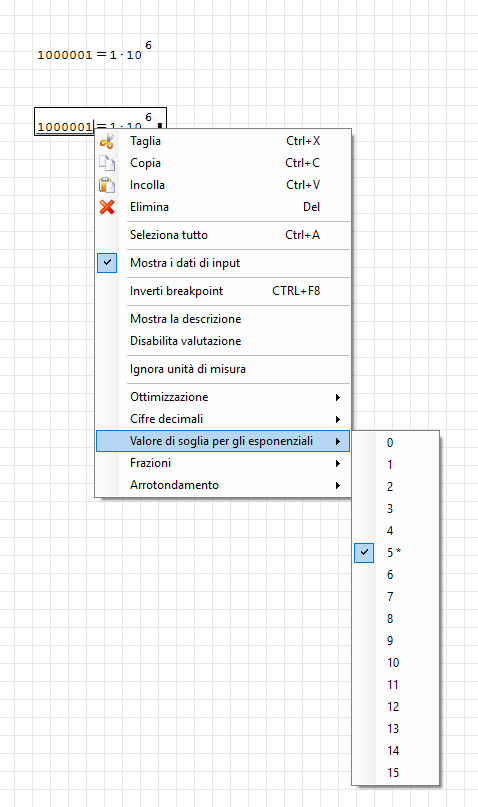

Yes, you can right-click on a result and change the number of digit after exponential notation is automatically adopted image.png.
There is also a global setting under "Edit", it will affect every calculation in a specific file (unless otherwise defined with above mentioned right click feature)
