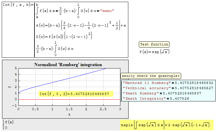

Smath integrator is Simpson. Occasionally exact as well as Poncelet [trapeze].
More genarally, very poor integrator. Observe great improvement from Romberg.
The last rescue in real Engineering works is Legendre.
As much as possible: try to get from Maple and/or Mathematica on-line.
