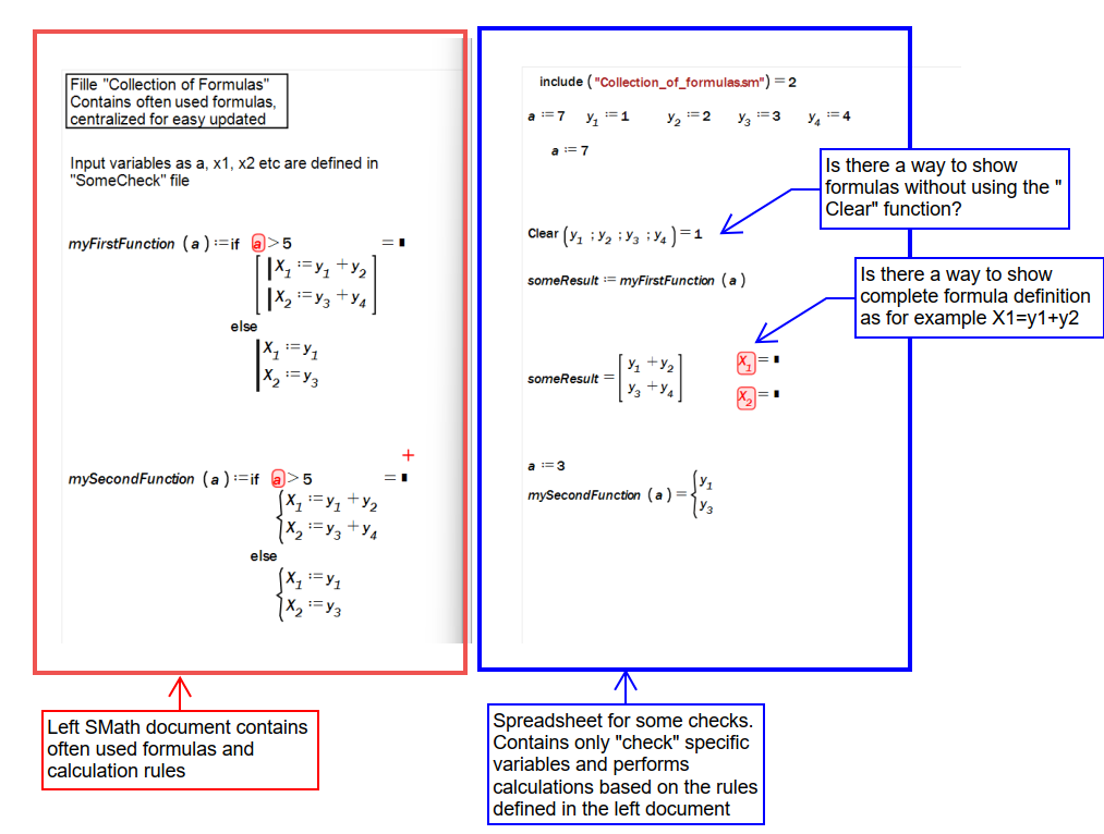

I am a structural engineer and I am trying to organize and centralize
calculation rules and formulas in a way that most of it is stored in a single SMATH file.
Doing this would make it easier for me to update functions if some changes are necessary.
When I need to perform some checks, I will read specific functions over "include"
The limitation that I am facing is that I am not able to find a way on how to
display the formulas that I am reading from the "central" file
In the example shown in the picture, I would like to see a complete formula definition like:
X1=y1+y2
X2=y3+y4
instead, only the right part of the formula is shown. As you can see I am using the "Clear" function and
I have set Optimization to none.
I am relatively new to SMath and I would appreciate it a lot if someone knew a way to display complete formulas or if there were some other ways how user-defined formulas can be centralized and easy to access
Thanks a lot

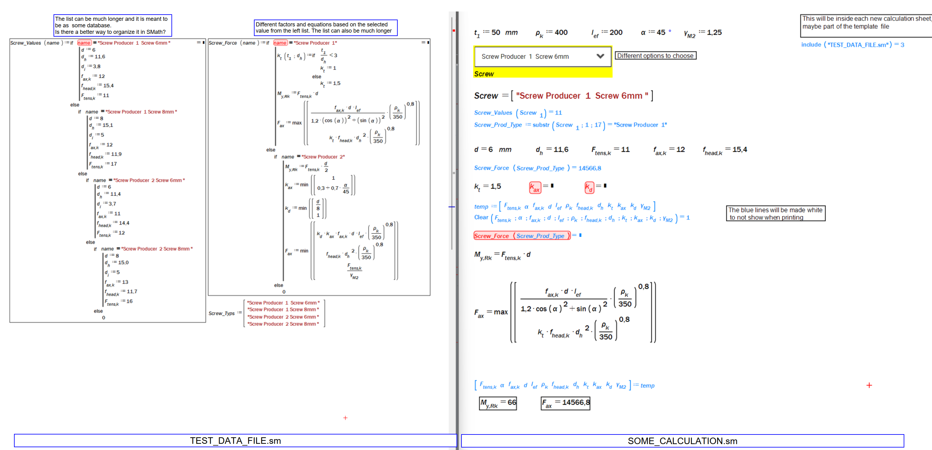

Please see my short example with Fax,k force (note:formulas are not correct).
In this case, I would like to have options to store different sets of equations that would be called based on the chosen values from the list.
Maybe something similar as snippet but that is not copied in the new file but instead it is referenced from some central location
I have managed to achive at some level what I wanted. I have stored values and formulas in a set of if statments and then I am including that file in
some checks. I still have to use Clear function to display the formuls that are stored inside included file.
If in the future some encapsulated function as you described in Point 3 would exist, it would be I think much simpler to define something like this

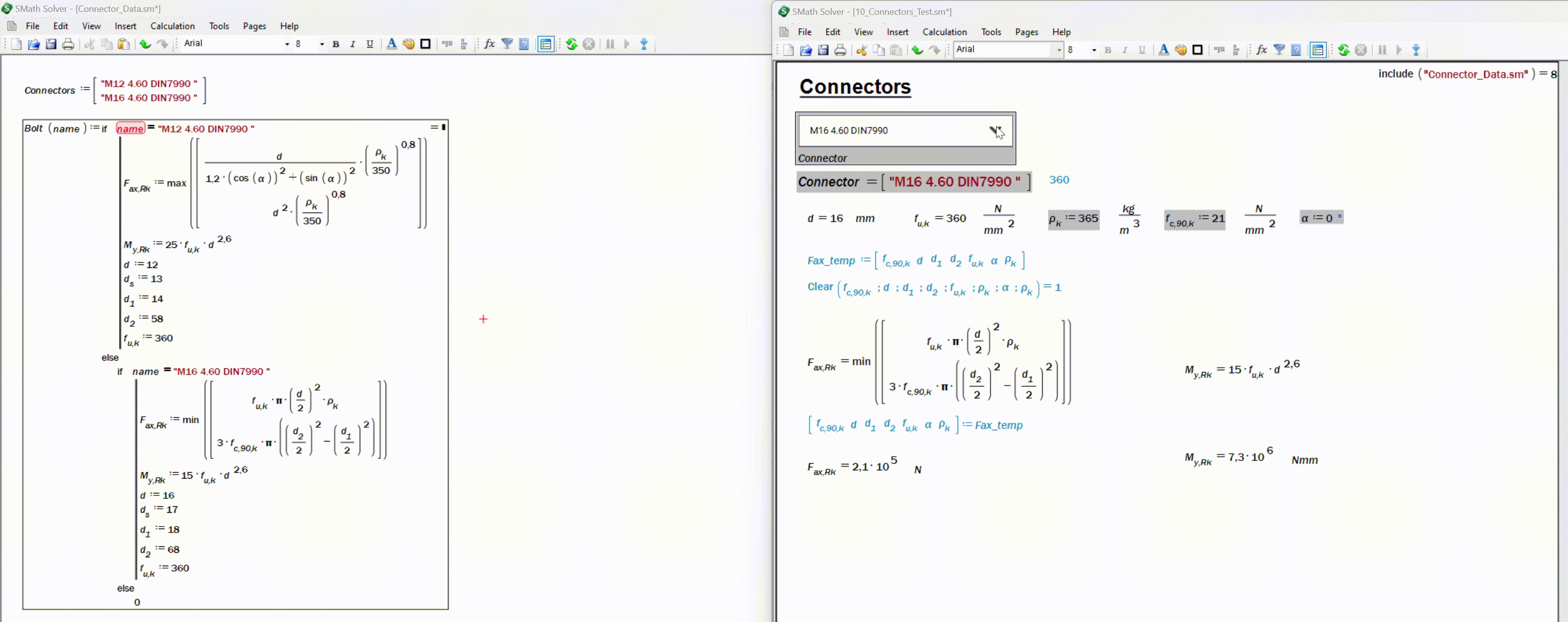

I've been working on some simple examples to achieve the following:
1. I want to use a single SMATH "Data file" that is included inside other calculation sheets. The file in this case is called TEST_DATA_FILE.sm.
2. I need to have a dropdown list in the "SOME_CALCULATION.sm" file, which calls some algorithms from the "Data file" based on the selected value.
3. It should be possible to display the called formulas.
4. Finally, I need to be able to calculate the results.
The best way I've managed to get it working so far is shown in the two attached files. As you can see,
I've had to use a lot of "blue" colored lines in order to show the formulas that are being used.
I hope that there is some more elegant solution for this
#6 Опубликовано: 16.07.2024 00:09:14
ioan92
ioan92
178 сообщений из 115 понравились пользователям.
Hi Faruk,
I worked a little for you...
Here after, there are my proposals:
Of course there are also other better solutions. Maybe some others could propose you something else.
1. It seems that you do not use correctly the user defined functions;
2. Take care units. I desafected yours (!?)
If useful please ask.
Ioan

Hi Faruk,
I revisited the information that I send for you and I have some observations that I submit to your attention.
1. I interchanged the lines for the definition of: Fax and MyRk; the first value must be already known for the calculation of the second;
2. I compared the results for two screws of the same diameter (8mm) from the two producers. They are very different, that means to me that there are some problems with the formulas;
3. I suggest that you include in your file some copy/paste of formulas from the literature sources, for a good validation of your code;
4. I suggest to you the use of units; this is simple and profitable;
5. I suggest including data for screws in distinct matrices for each producer. It is also possible to import data from Excel files.
Feel free to ask if you feel useful. Me as others have started as beginners; that has nothing abnormal.
