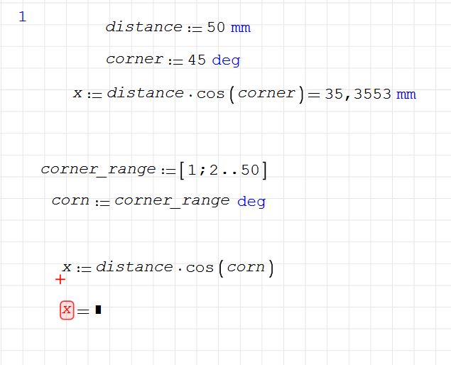

I have problem with rank along with unit.
Par example: x = 50mm * cos (30 deg) = 35,35mm
But when I use range corner = 0,1,2...50
x = 50mm * cos(corner) don' work!
I try with vector, but it don't work.....
Thanks

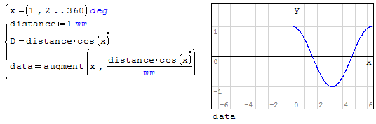

in fact, the solution has already been given to you.
cornerRange.sm (6,1 КиБ) скачан 1275 раз(а).

If you pay attention to the others solutions, you missed the VECTORIZE function
