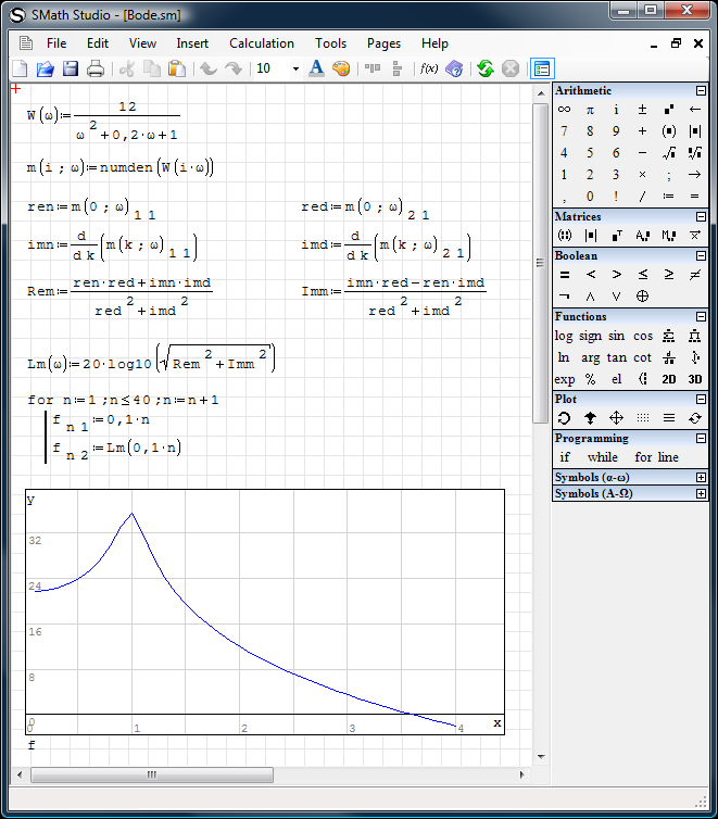

I am using Smath for calculation of stability for switching mode power supply.
Now i tried to plot a transfer function F(S) with poles and zeros but the 2D graphic cannot allow to have an logarithmic X axis.
Have you planned to add this functionality or is it possible to substitute the x array with a logarithmic ones?
Giuliano

Here is some workaround:
Bode.sm
Yes, but it is not urgent task, so I can't say how much time it will take.
Best regards, Andrey Ivashov.

Probably a bit early to get picky, but a real Bode plot has log frequency on the x axis, and log magnitude or dB on the Y axis, and immediately above that a second graph pane showing phase, wrapped at either +/-180 or 0-360 degrees.
However I see that electronics people put the phase UNDER the magnitude plot.
#8 Опубликовано: 19.11.2009 08:11:58
allanon77
allanon77
You are right. This is what I want.
Now I am trying to understand what wrote Andrey, it is a bit difficult for me (this is why I have not answer yet).
What I thought to do, is to create an array with a fixed number of points for a decade.
Use this array to calculate the transfer function instead of using x.
At the end, I plot in 2D graphic these points with logarithmic axis.
In Mathcad is something like what you find in this link
Mathcad Transfer Function
