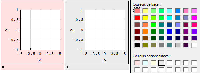

A useful tip => if no background exists in the work sheet,
X_Y plot will be white, no way to border the plot frame.
Otherwise, if a background exist, X_Y plot frame will be
by default of the existing selected background. Further,
you can have the "Display input data" of any other color
of you choice, independently of the border plot frame.
A delicious Smath native feature, nice for publishing.
