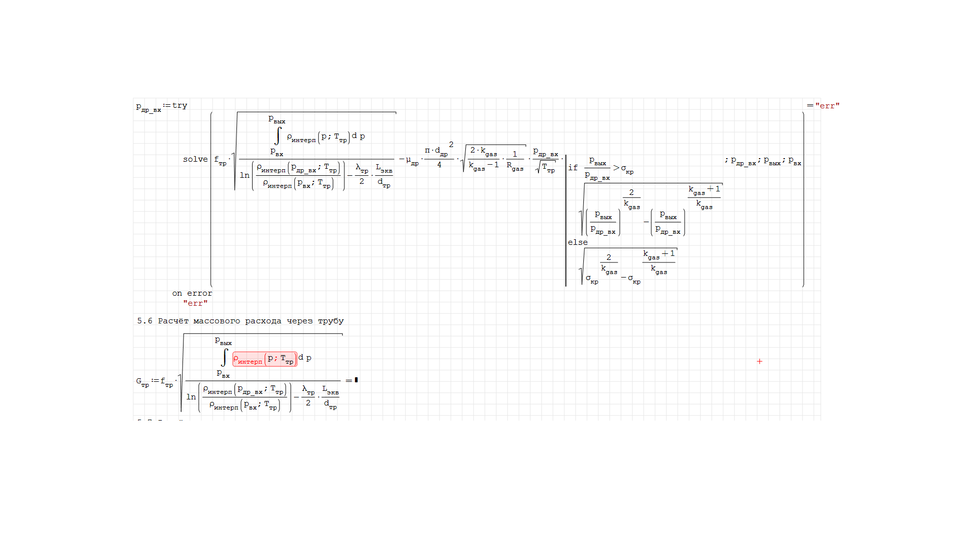

For a long time I can't solve the problem in this program, I can't find the roots

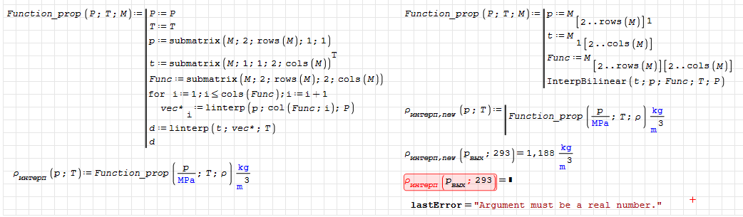

The first error message is in Function_Prop
It says "must be a real number" ?

Still red top2bottom
As it looks, you are attempting to integrate kg/m³ over 'p'
for the given 293 °K ... done otherwise finite differences.
In your solve block, vary many things are constants that could
be simplified but so many are undefined.
What should this solve bloc should do wrt the integration ?
find an intersection wrt some 'P' or else ?
The meaning of the cumulative integration reads like this:
"for °K 293, accumulate the kg/m³ over the 'p' range'
In other words: the cumulative mass-flow kg/m³over 'p' range
Raschet propusknojj sposobnosti truboprovoda s drosselem na vykhode (1).sm (1,53 МиБ) скачан 1274 раз(а).

I don't understand you. What should I do? Or, if You can, please correct it
This is the correct response to the variable that should be obtained in the Solve function
I fixed Function_Prop using InterpBilinear() from the Statistical Tools plugin. Note that the definition without line operator behaves buggy, because you even won't get the usual storage preview when hovering over the definition. This is strange and indicates something really bad under the hood.
Yet fixing the function doesn't solve any of the problems downstream. But given the strange error messages and bugs I'd say build 7251 can't be used safely anyways.
BTW, instead the if-else cascades I'd recommend using the selection index as index of a vector of options.

Perfect, may be you can solve "SOLVE" function in this program???
#13 Опубликовано: 14.03.2020 21:26:36
Perfect, may be you can solve "SOLVE" function in this program ???
1. Up to this point: NO ... μ.др is undefined
2. If μ.др has a value: plug it in this document.
3. Please, don't re-post your original, so I can do more
from this document.
4. Units don't match in this project.
Raschet propusknojj sposobnosti truboprovoda s drosselem na vykhode (20200314).sm (1,52 МиБ) скачан 1255 раз(а).

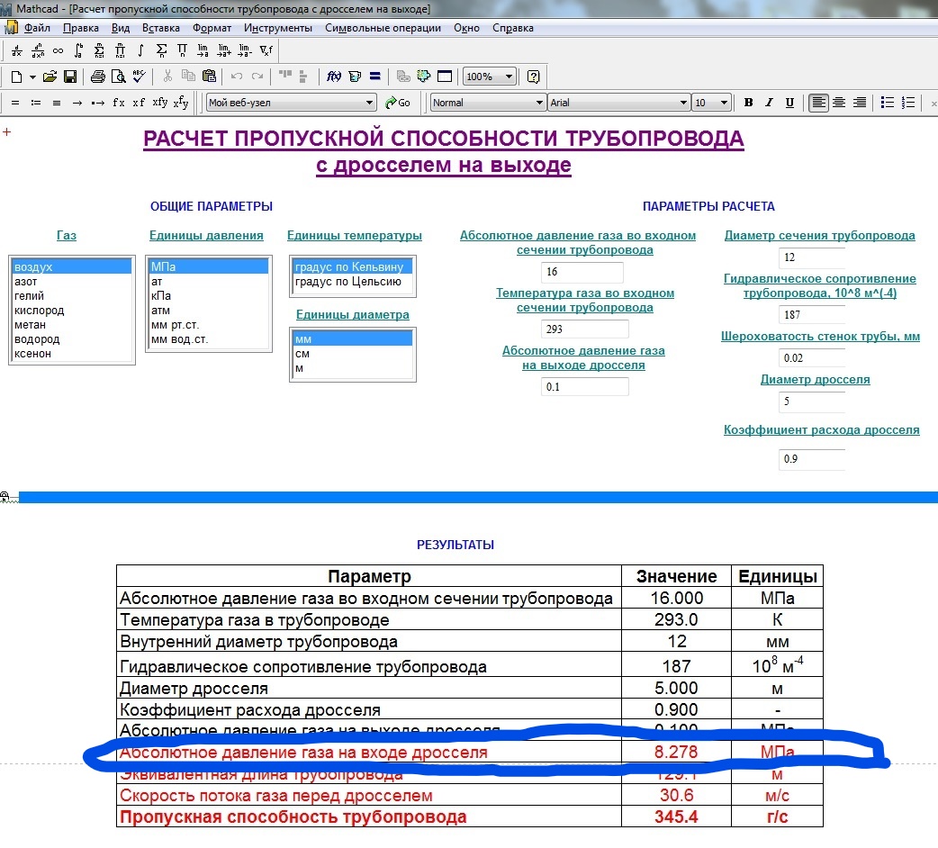

The answer does not match, it might be better if I attach a file from MathCad. I have to translate the program from MathCad to SmathStudio, but sometimes I get errors like this.
Raschet propusknojj sposobnosti truboprovoda s drosselem na vykhode.xmcd (487,33 КиБ) скачан 1312 раз(а).
Here is the answer, sorry, that in Russian
... then check if the "Bloc" you have constructed is OK.
Tabulate the Mathcad "Bloc" that you have translated Smath.
My working Mathcad is 11 not connected to Internet,
My XP Pro. has no AV . If the two MCD/Smath blocs don't
agree/tabulate same: then your translation is in doubt.
#19 Опубликовано: 20.03.2020 12:11:57
Your Smath ρ vs pressure [p] does not correspond to MCD.
I can't help more from so much not clear.
Check with Viacheslav, he is with MCD ... Maybe Radovan too.
