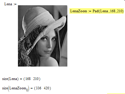

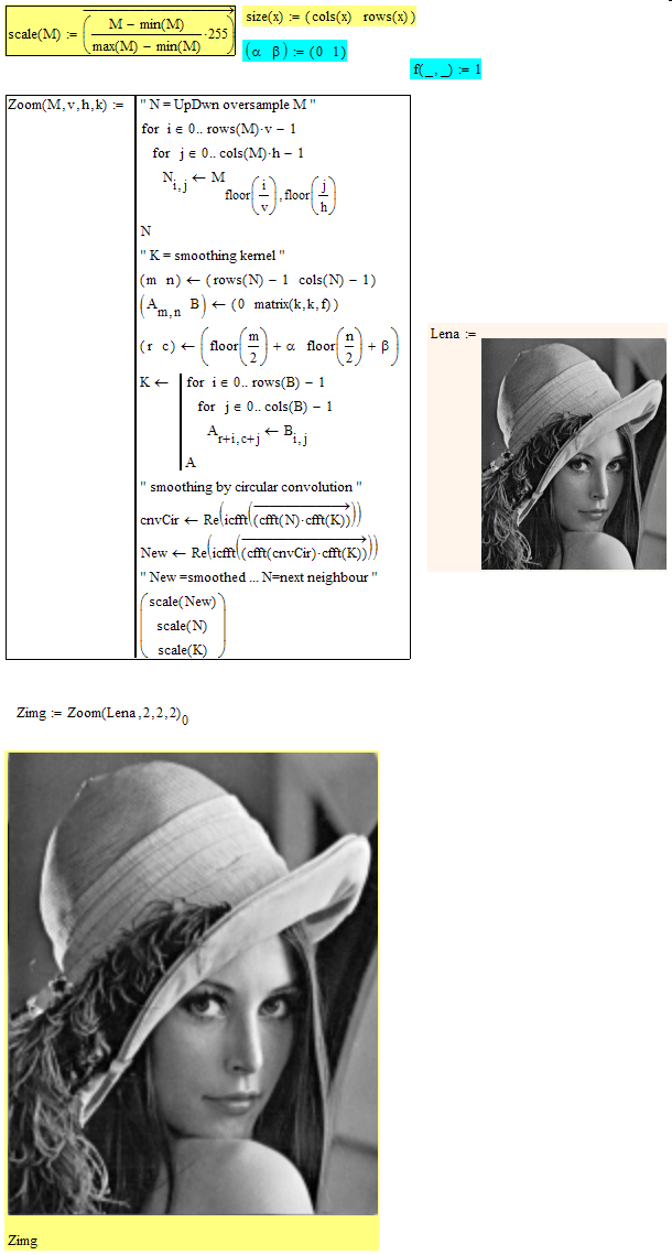

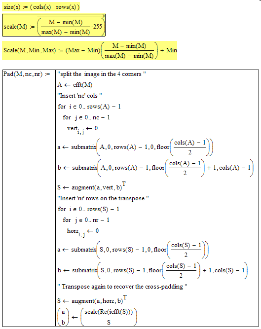

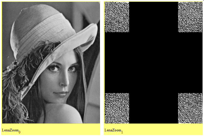

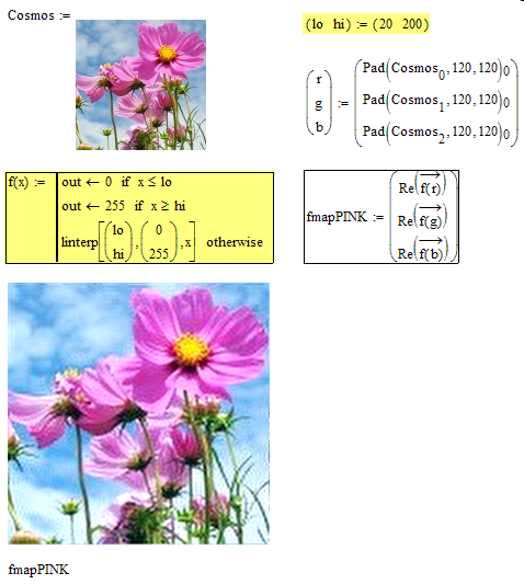

Smath READRGB extracts very quick an RGB [bmp] image in the PC.
It does not read *.png because not in 24/32 bpp.
The web site shows R, G, B in NotePad style.
It is bidirectionally compatible with Smath
NotePad <-- Smath
NotePad --> Smath
Two points here:
1. If you can make a drawing in 3 augmented vectors format,
easy to rotate. In 2D vector will rotate anti & clockwise.
The condition is that the vectors are Smath = Drawing.
If a drawing gadget is only compatible to Smath, no use for it,
Smath is still a curiosusity. No idea if that plugin is worth
developping as a poor product compared to other more advanced
and accepted graphic packages. It would have very limited
audience and there were a lot of those gadgets few years ago.
2. About image and what Smath can do: answer = nothing except
open *.bmp and extract R, G, B . No matter the effort to do more
than nothing it can't take the components and remake RGB of it.
The attached work sheets may be interesting in the context.
